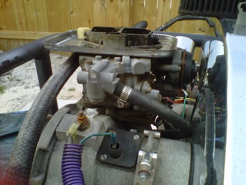

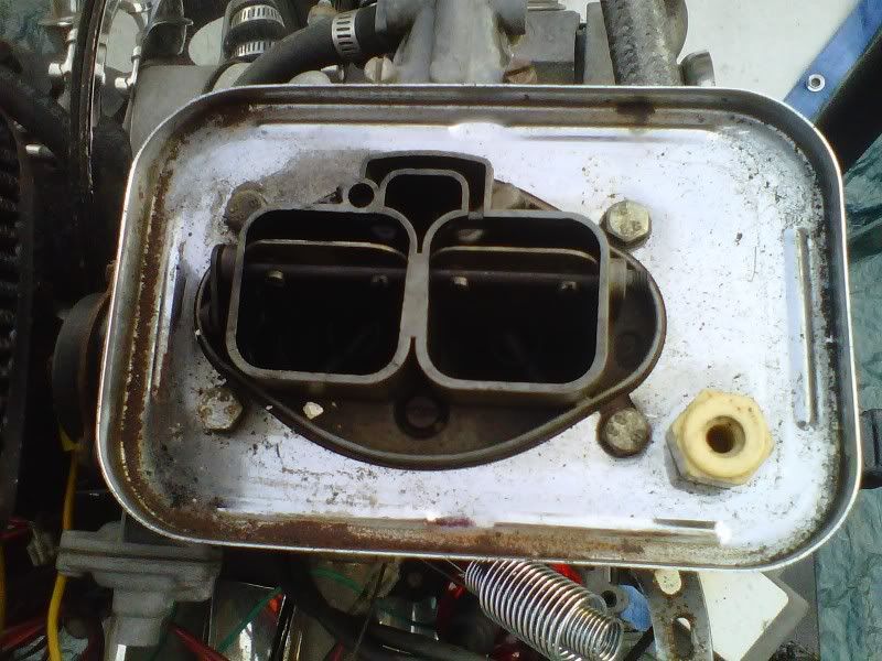

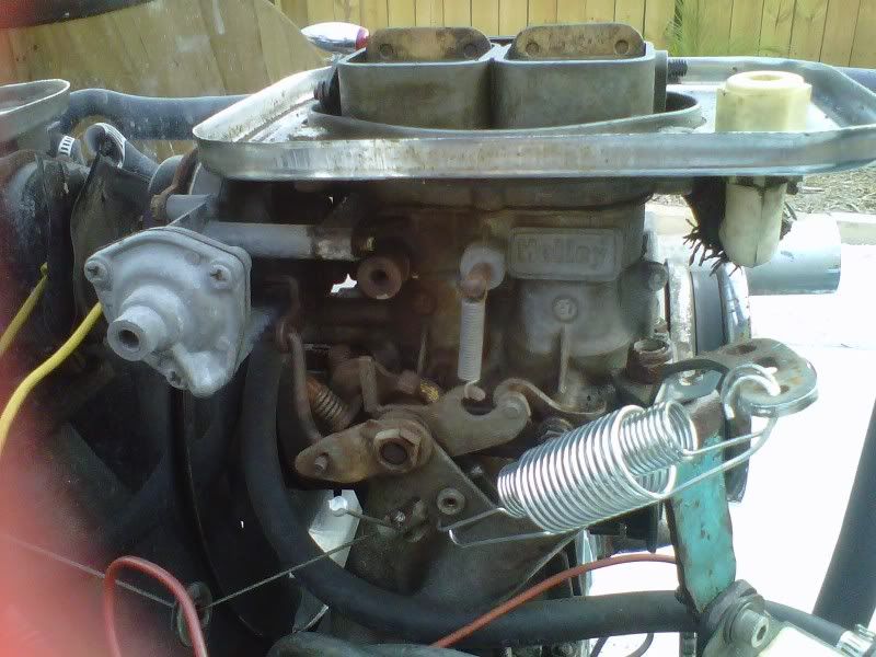

What kind of carb is this?
May 6, 2011
30
0
florida
I know its a Holly, but thats it. I need to get a rebuild kit for it.
Any have info or a link for the kit?
It says 650 30 on it. Not to familiar with this stuff yet.
i was thinking that :( was hoping it was something decent lol. Save some $$$...
Im thinking this is the root of all my issues, hard to start, not much power. Wants to stall when i give it a bit of gas.
i may have found a guy that can get me a weber carb on trade for some parts i have. If it does not work out ill let you guys know and check out that site! Still would like to know more about the one i have if anyone can help. Thanks!!
The carb that you have was originally made for use on a Ford Pinto and a Chevrolet Vega, and was soon afterward adapted to us on VW's. I can't guarantee these numbers but I think those carbs were Holley 7200 and/or 7210's. Performance was great on the VW aircoooled motors, but every one of them required some re-jetting to get them to act right.
I think it might be a good time for an upgrade to a later version carb versus trying to rebuild and possibly playing the rejetting game.
