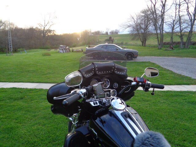

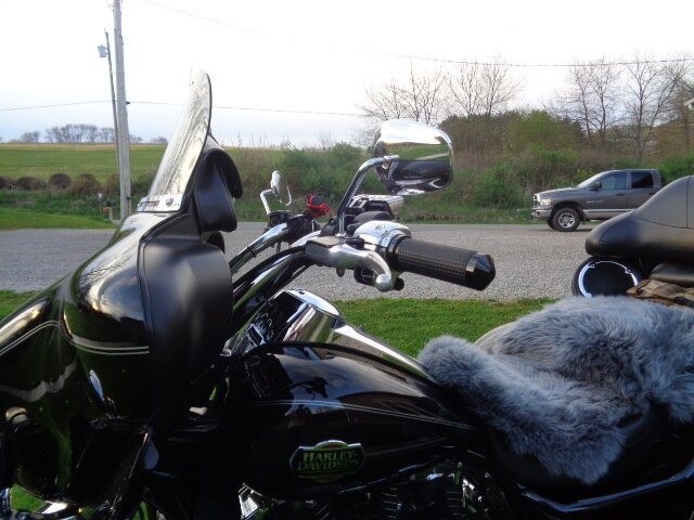

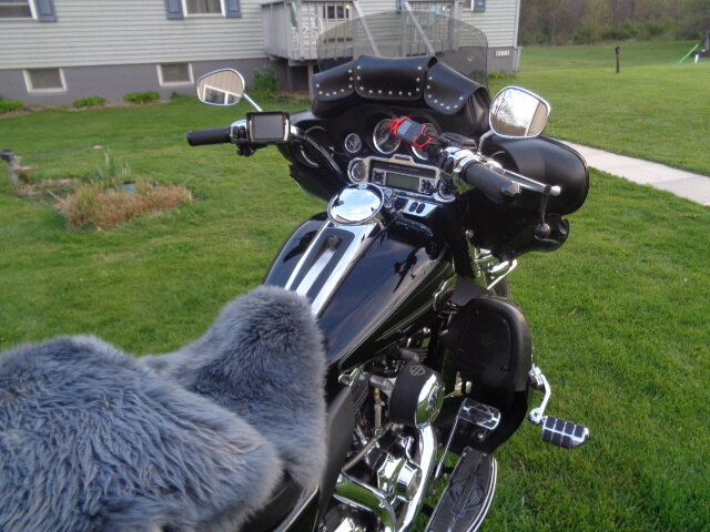

First of all Welcome to the forum Western Pennsylvania stop by often great people around here willing to help. Bars are a very personal thing good luck on your search these are what really worked for me, I needed help with back and shoulder aches. Khrome Werks 2+2Wide Sweepers did it for me, and at a working man's budget. These are 4" wider than OEM and 2" higher 2" back closer. For me they were exactly what I was needing.
When changing to these on my trike I installed a longer Clutch cable that was all that had to be changed, I did it myself for less than $250 dollars. Ride safe Fred Good luck!

I wonder if these would work with the 2" tank lift. I like the looks.
yes I have a 2" lift on our Triglide they fit great. Most likely the best bars for lifted tanks. I posted pictures in this thread check them out. You will really like them I do. Fred
