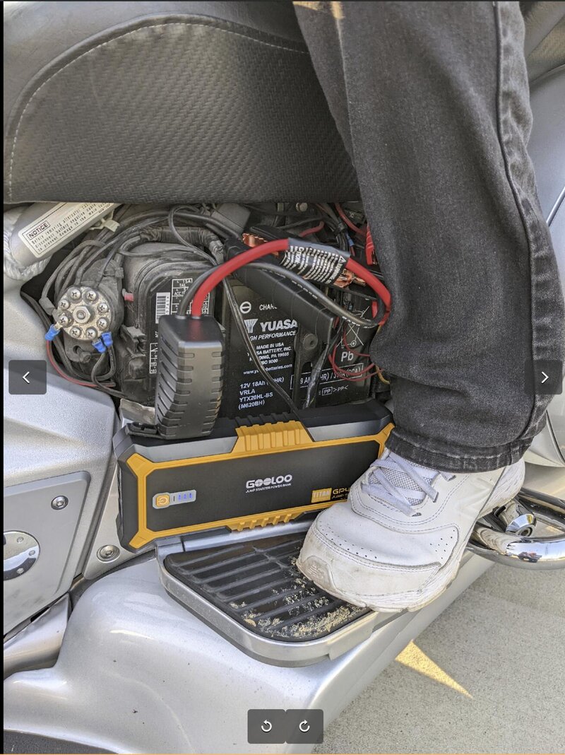

Then I remembered I had put the Lithium jump starter in the front storage of the trike from the car where it’s usually setting before heading out! I forgot about it as I got in the habit of just doing it …With the side panel off and the battery terminals exposed I was able to connect the large clamps of the jump starter to the battery posts and stand the starter pack on it’s side on the passenger floorboard. Connecting it up and then starting the trike we were able to ride the trike 1 to 2 miles before it would die…
We did this a few times, with each time the riding distance being shorter…. then I realized I should unplug the headlights, as that would probably be the largest current draw… so I did…After unplugging the headlights we were able to start and splutter a short distance, find a decent pull off and then do it all over again…. many, many, many, many times… until we were home!!!!

Yes Sir, it does. Mine is attached to me bike battery and comes up by the back rest. If ever I need a jump, I simply plug into the jump starter.

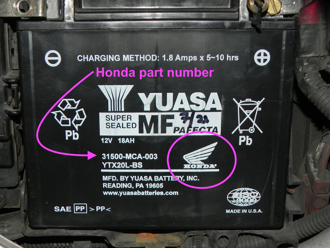

That's what we do here too. Plus we order our batteries from Honda with a Honda part number, not the over-the-counter Yuasas. In addition, when we activate them, we follow the instruction in the box ... add acid, wait 1 hour, put on a 2amp charger. Depending on the battery, it might take anywhere between 3-6 hrs to fully charge one. It is then removed from the charger, and tested per the Service Manual. If it passes, only then is it installed.
