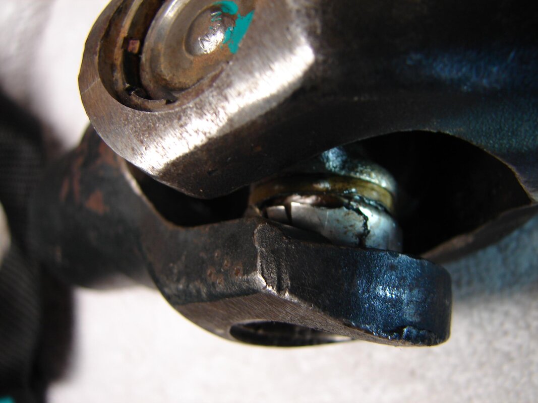

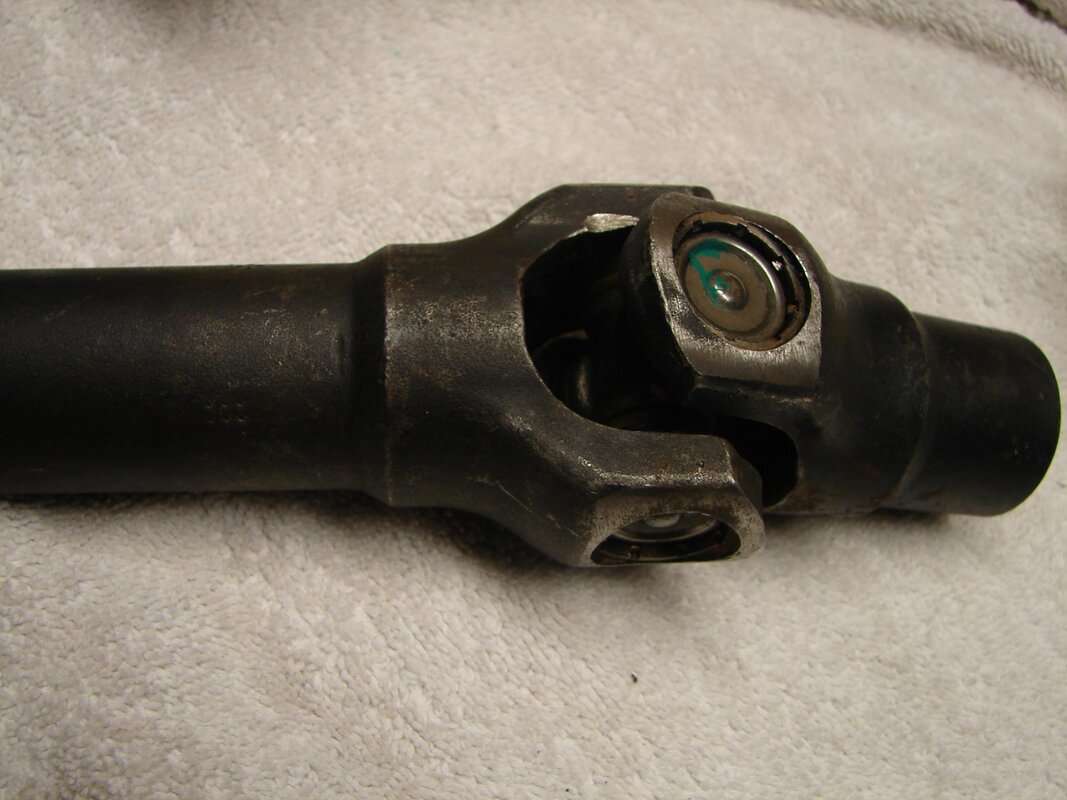

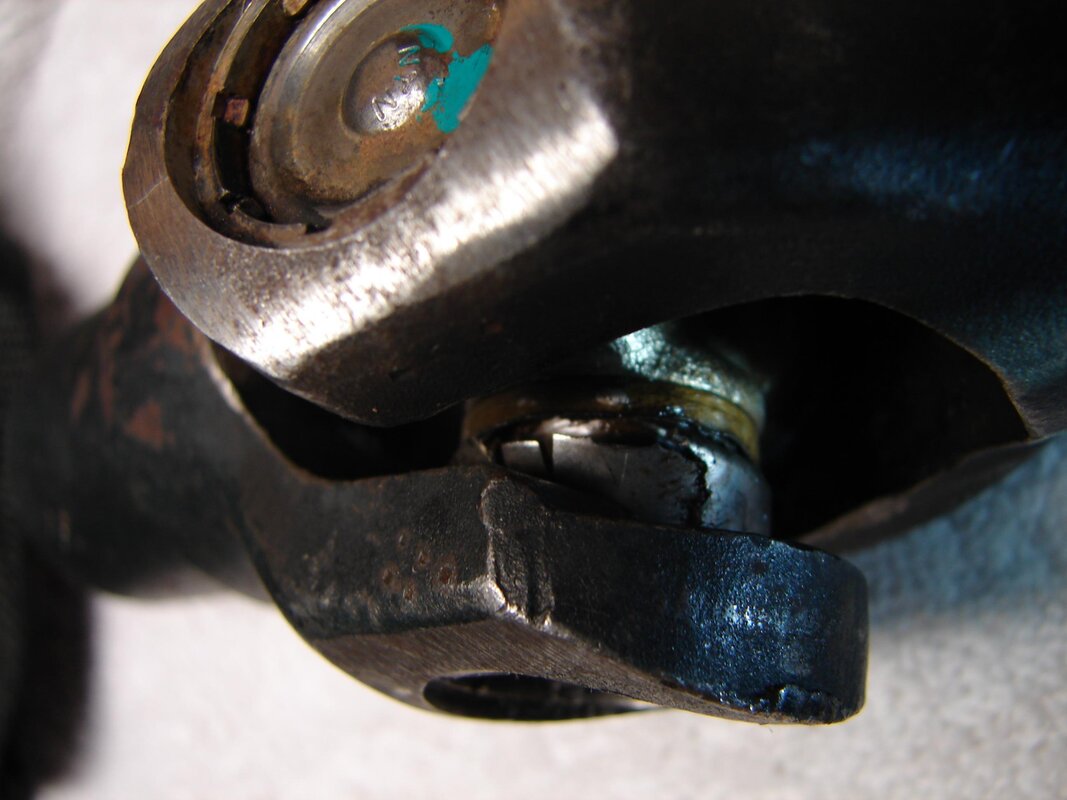

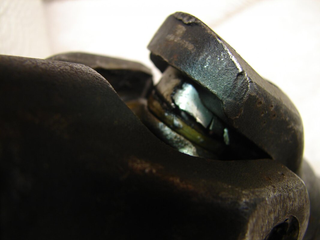

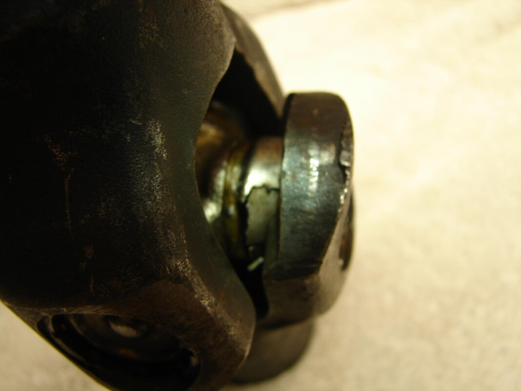

Hey want to see whats left of my front U-joint after it started to give way???
My Trike dealer said it was the FIRST one he had ever seen where someone "CAUGHT" it before it let loose :D
When using engine breaking it made the most hideous chirping sound
Here is a picture of where the yokes were hitting see the wear marksDSC00147.jpg

I don't how long this was going bad but I did something the other week that I KNOW did not help it.
I accidentally down shifted into first. I clutched it quick when I realized what I did.
It may have cammed the ujoint, or perhaps it was going bad all along.
This WOULD explain when I started hearing the noise when I did.
It only clanked when I would use engine braking; Like Down shifting from 4th to 3rd.
Ya just never know.
But I am glad it went bad before our long trip this weekend!!!!!
and 2 weeks after that!!!
Dammit why don't these bikes have a shift indicator!!!!???
