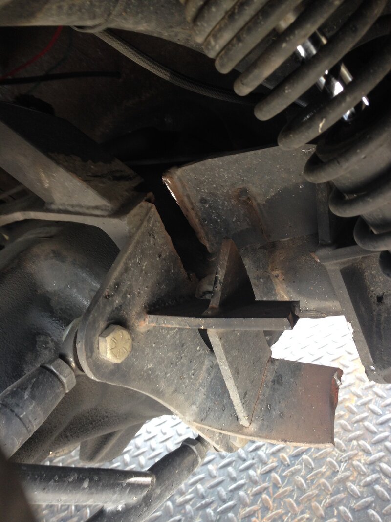

This question is mostly for any VTX trikes. Have any of y'all had any problems with a rear axle bracket. About a month ago mine broke and had to have it towed 30 miles back to a Honda dealer.They had it for 3 weeks and Motor Trike wanted to see it and now, they have it. It's been over a month with no trike and that driving me crazy. Any help would be greatly apprciated. image.jpg

From looking at the pics only, it looks like the two places, top & bottom that we can see, have been broken for a while. Just a little shiny area from the weld, and mostly rusty area where weather has been getting to it. Kinda looks like poor weld penetration, also.
I don't recognize the area, must be an IRS model. My straight axle appears some heavier built.
If you take any more pics, back out a little to show the area, just for my curiosity. :)
Change the title to Motortrike kits. you'll get more responses.This has nothing to do with the VTX. It is a MT problem. Same kit on many brands of bikes. Mine happens to be a Champion.

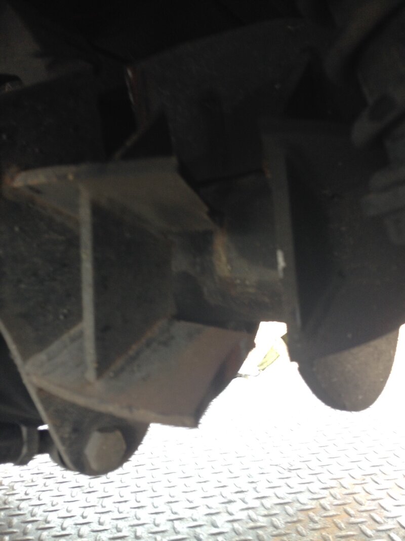

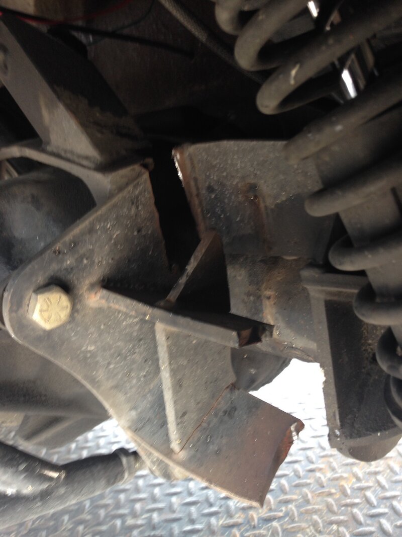

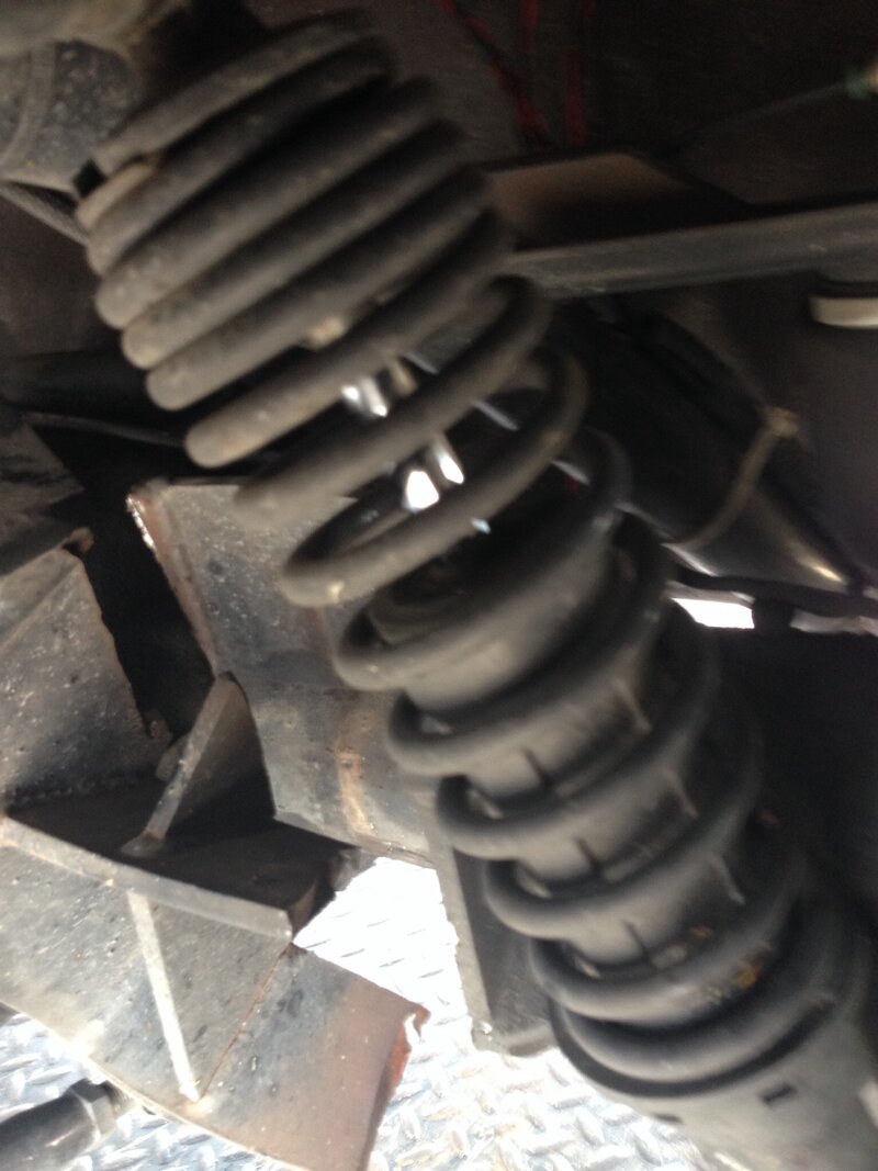

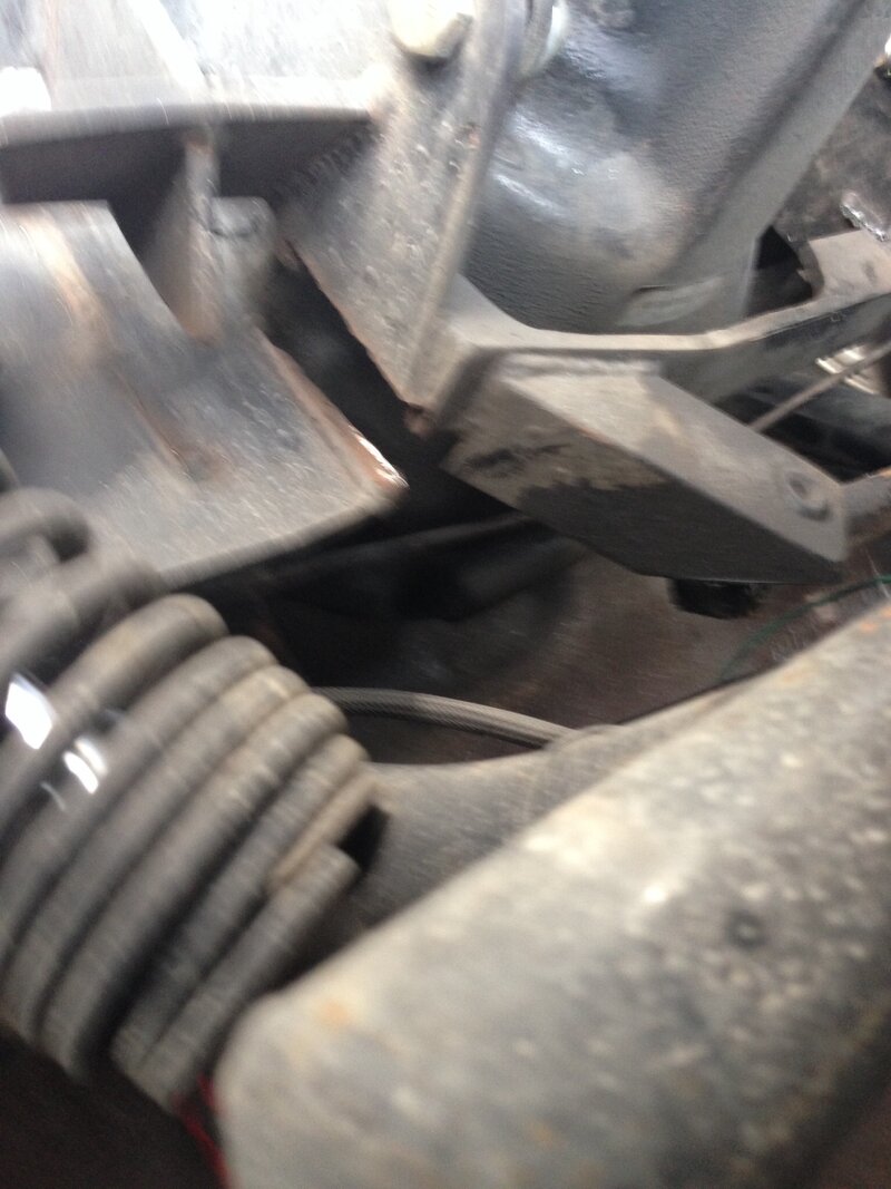

these are all the pixs that I was able to take. Talked to Richard @ MT and had a good conversation with him as when I might get trike back. Now going on 5 weeks, tough but almost see the light at the end of tunnel.
