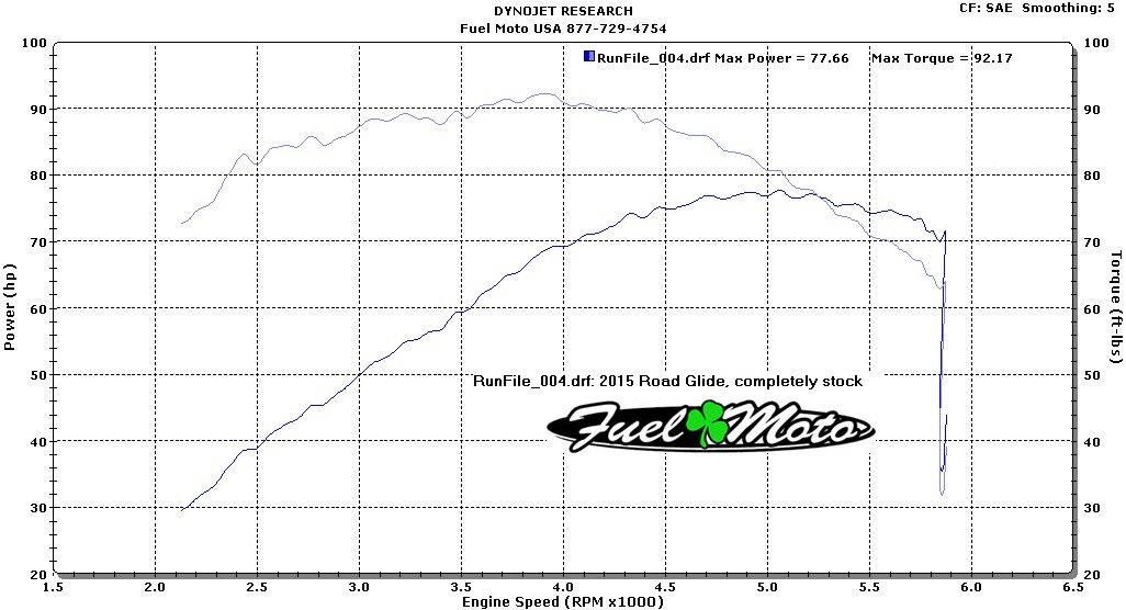

I didn't do a lot of digging but found this on the FuelMoto site, it's from a 2015 Road Glide
I would say more like 96 on torque and 74 on horsepower.
Thanks much, Zammy. Your findings seem to confirm trikeharley's numbers. Not bad, I suppose, but the 110 upgrade is looking more and more appealing :)
Don't go by two wheeler dyno numbers. There is a lot of drivetrain drag on a trike so the numbers will be lower. I saw a run that had cams and the numbers were 105 tq/90 hp at best.
I believe the 103's are putting out between 100-105 ft. lbs. AT the crankshaft...but at the rear wheels it is closer to it is going to be closer to the high 70's to the low 80's.
This can be greatly enhanced by a good Stage I. You should be able to get up near 100 ft. lbs.
