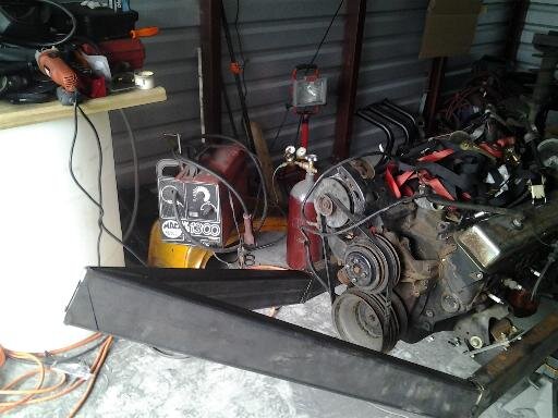

In late March I rented a 10x20 storage shed, bought a generator, as there was no electricity, and started up again.
Yes that is snow in the previous pic.

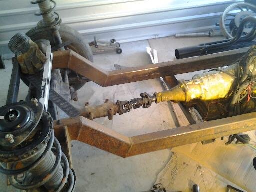

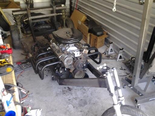

I bolted the rails to the rear end and then started fitting the engine/trans.

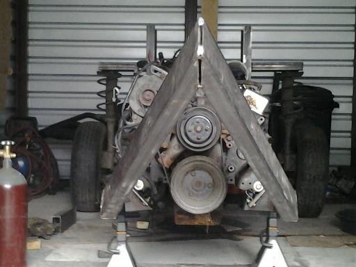

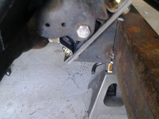

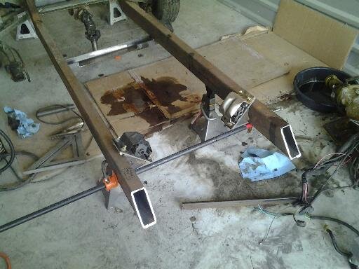

With the rear end as a starting point, and the engine being directly related to the rears location, I started moving from rear to front locating mounting points. Engine and transmission mounts first.

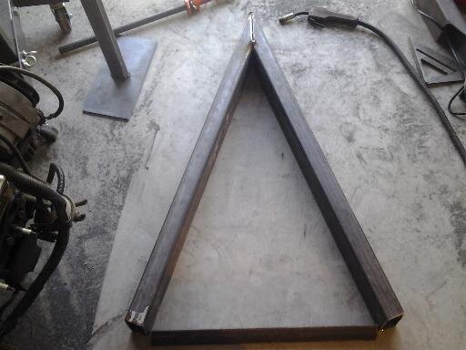

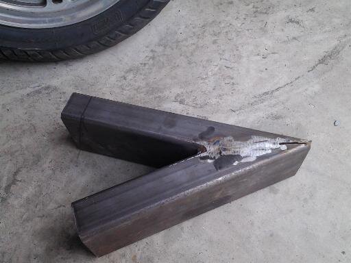

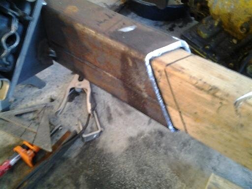

Next I went to the down tubes. I found out that wood 2x4s fit into the steel 2x4s and make it easy to compare complex cuts on the two frame rails by scribing a line around the wood with a magic marker.

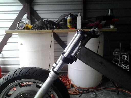

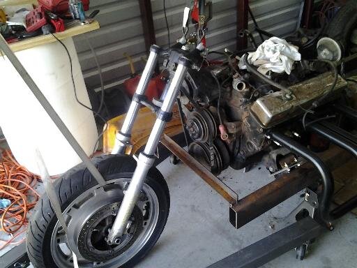

I was originally thinking of mounting the neck close to the engine, but thought it might put too much weight on the Goldwing 1500 front end.
I moved it out a bit, and now there is 5 feet from the front wheel contact patch to the center of the engine and 5 1/2 feet to the rear wheels from center.

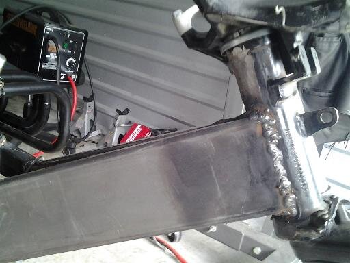

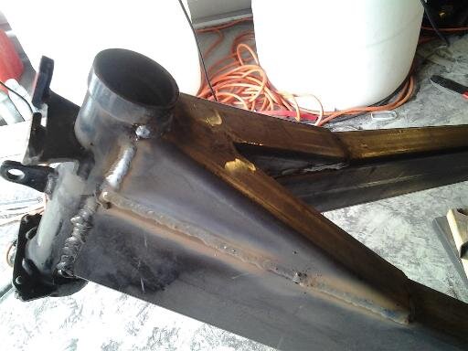

Once I got the down tubes in place, after MUCH ado, I drilled a 7/8" hole, top and bottom of where the neck would go, cut the sides to fit, and welded in the neck.

In my last post, I should have said that I drilled a 1 7/8" hole as that is the diameter of the neck from the Goldwing. I tacked it in place and checked the overall look.
I wound up with around 31 degrees of rake, close to the stock 30 deg. There might be a rake kit in the future, but that's to be decided after testing.
I made an extension to support the rest of the neck and welded it in place.

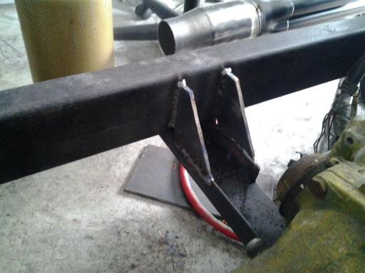

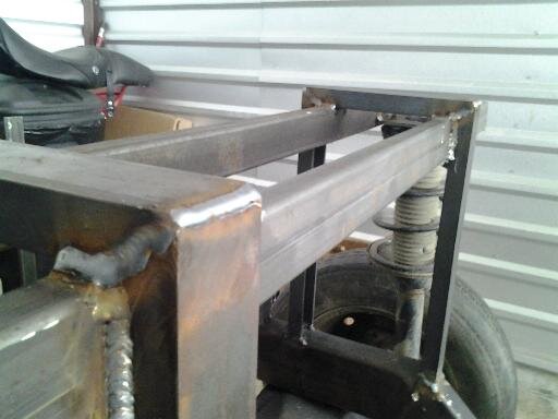

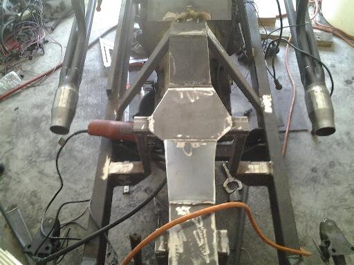

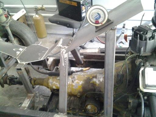

I strengthened the trans cross member and rear strut towers.
Now it's starting to look like a trike.

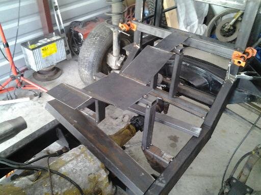

I flipped the Road King seat over and cut some 10 gauge steel into rough shapes of all the bends of the bottom, spotted them together and started mounting the support pan where it would sit on the bike.
Once I was happy with that, I cleaned all the edges and got it ready for rubber padding and paint.

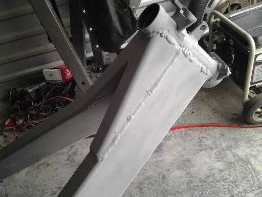

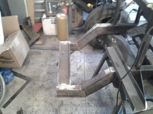

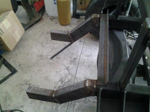

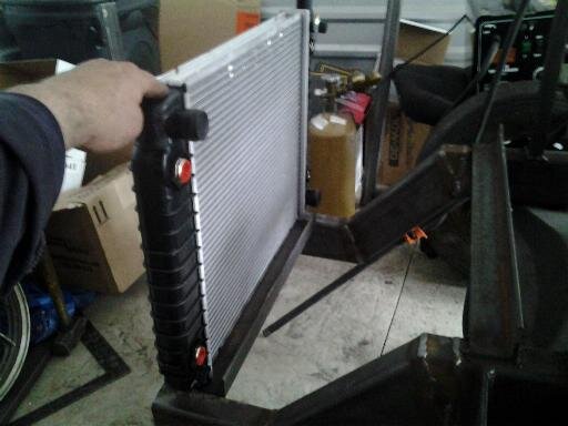

After extending the rear frame, I added some 4 inch channel as the bottom mount.
I am getting some brackets bent up for the radiator mounting and will start plumbing coolant and trans lines while figuring out the dash. I think I have an idea, but what actually takes place remains to be seen.

Sorry for the disappearing act. A lot of things have happened since my last post, but little progress on the trike. I have bent up a bunch of stainless tubing for the cooling and located the radiator in the rear, but the cooling system is incomplete at this time. Unfortunately, I can't foresee any large allotment of time to put into her in the near future, but miracles do happen. With some significant progress will come pics, and hopefully RIDES:D.
