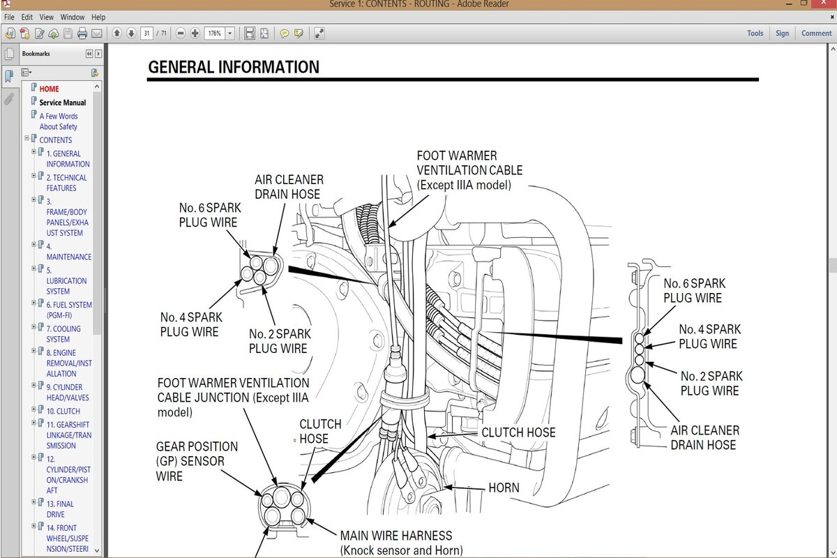

Hey Jay, I'm setting here in Eureka Springs waiting out rain, lightning, and thunder bumpers so I have time to search some. If the control is connected then there are only a couple other possibilities...
Here is where the single cable splits going left and right.
If that becomes disconnected or the single cable is broken both foot warmer vents will pop open. If only one side is open then that leg if the split is either broken or loose at the actual door.
Hope that helps...... :xszpv::xszpv:
