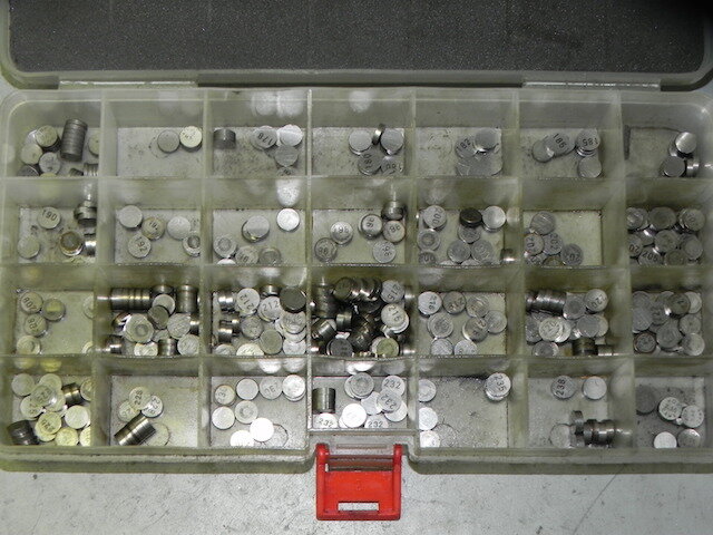

If the shop you choose does not have a large inventory of shims, you might want to find another shop. Very few are willing to tie up shop space for 3 days while waiting on a $7.25 shim. My shim stock is valued at over $3000.00
