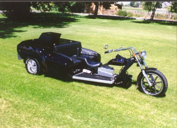

I built two trikes with V-6 engines and FWD transaxles. One had the radiator in the stock position, right behind the passenger, and the other had the radiator in the rear. Both were surrounded by bodywork, and both worked well. It's all about making an enclosure that creates a postive pressure area ahead of the radiator and having sufficient airflow. PM me if you have any questions.
