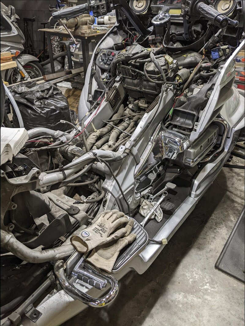

I just spent the past few days in the garage and replaced the rear shock spring and wow, what a difference it made....
A new progressive spring and replaced the hydraulic hose while in there.
The joys of motorcycle work....
I forgot how nice being "sprung" properly felt! I should have replaced the spring when we converted the bike to a reverse trike about 5 years ago... but alas...
The weather is warming up for this coming week, so should be able to get her out for an extended ride...
Pretty fun getting to that top shock bolt isn't it?
I had read where some people were able to raise the gas tank a tad and get to that bolt. I just couldn't see my way there.... I also took the opportunity to mess with the ground lugs and coolant hose clamps while the tank was out.
I just didn't plug back in the antenna for the radio before finishing up... so after a first run I came back and got back into it enough to get it plugged in...
