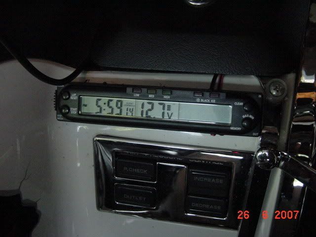

Here's an interesting little gadget that displays time, temperature and system voltage - all digitally. I have 2 of them (one green, one blue backlight) - one on each trike.<br />
<br />
It's about $10 and arrives from China in approx 3 weeks. I got it specifically to monitor the system voltage, but the rest of the information is useful.<br />
<br />
It plugs into a std 12v outlet that is "hot" when ignition is on (or cut off the plug and wire it directly to a proper source). When the ignition key is off, the time (only) remains displayed via 2 button cells that last about a year.<br />
<br />
Click <b><a href="http://www.ebay.com/itm/360802037708?_trksid=p2059210.m2749.l2649&var=630190304762&ssPageName=STRK%3AMEBIDX%3AIT" target="_blank">HERE</a> </b>
Where did you mount this (below) monitor? It is 3 3/4" wide X 2 1/8" high. Fairly big. There just isn't much room on the GW dash.
Would appreciate your comments or photo would be better.
Click HERE
Here's "quick pic" from my phone. Base mounts with double stick tape (provided) and could probably be mounted elsewhere, but this works for me. Looks "big" in picture as it's closer to the camera - but in actuality, not all that bad...

I have this mounted on the right side under the right fairing pocket with velcro
tells me Voltage,outside temp and time.
hooked directly to battery.
Back lit. I think it was aprox $25.00
