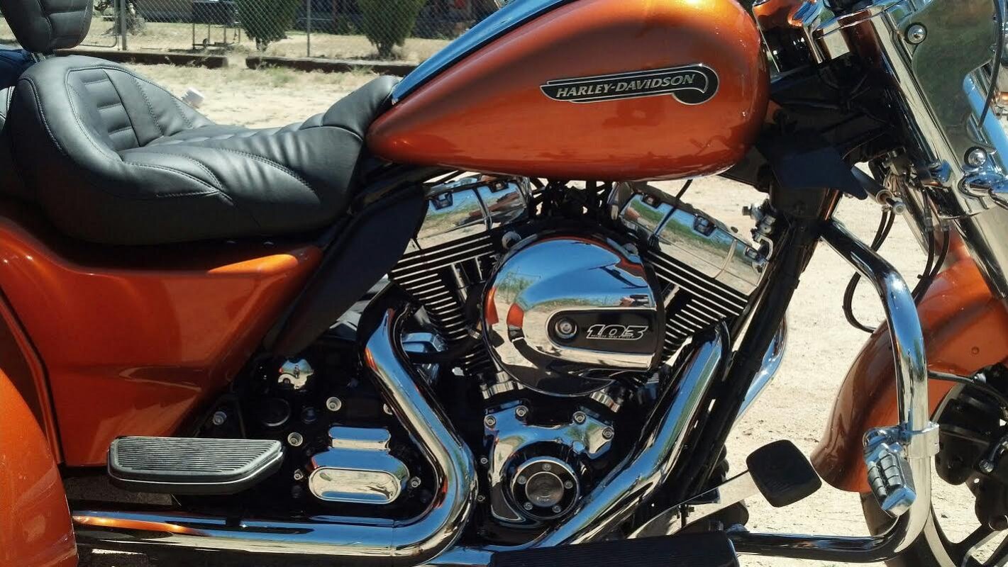

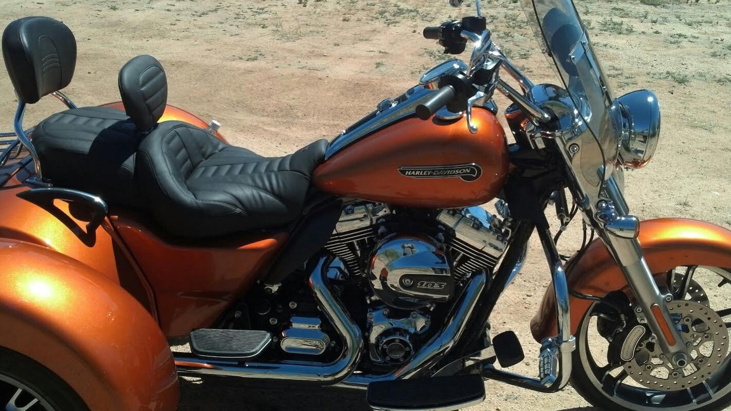

Here's a pick on my 2015 Freewheeler that also shows DK 2" tank lift; DK lower wind deflectors and DK outlaw 606 Air cleaner with stock Rushmore cover is a real boost in power over stock and relocates the breathers away from intake!
The right side only deflector lets the air blow thru the rear of engine look up DK customs they're supporters here Kevein has ton's of info on his site that helps cool the Twin Cam Engine!

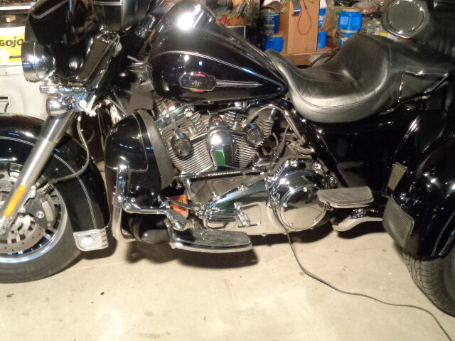

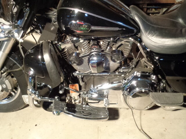

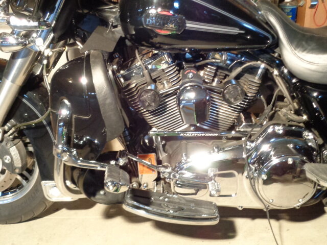

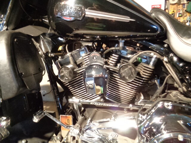

I removed my left side...
I tried the removal of factory air deflector and it does make a difference. I believe I have picture of left side. Works for me I asked Bride if she felt anymore heat she said nope works for her she also was watching the ET on the power vision.
