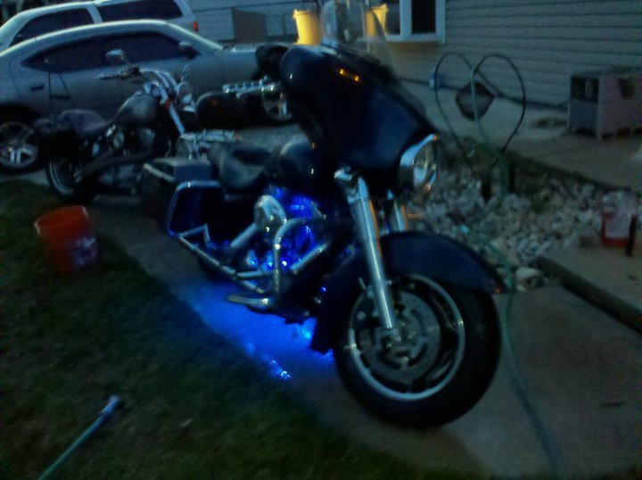

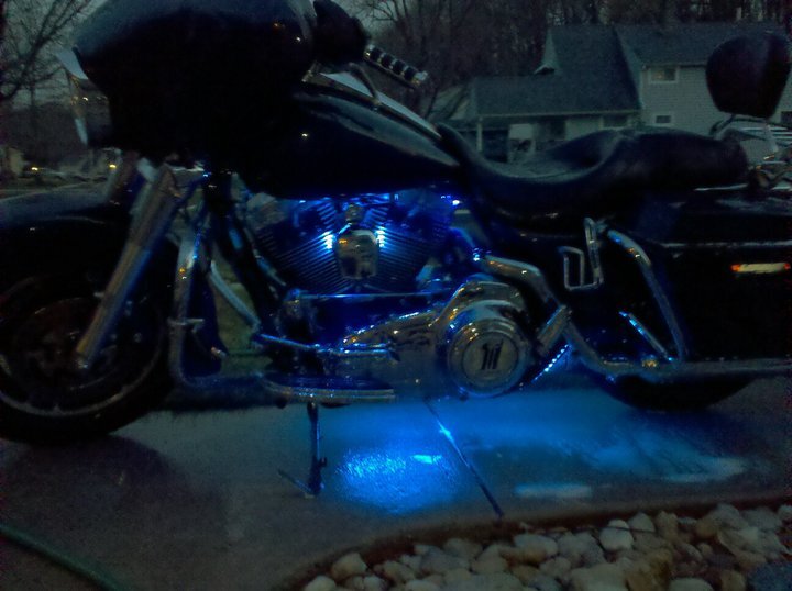

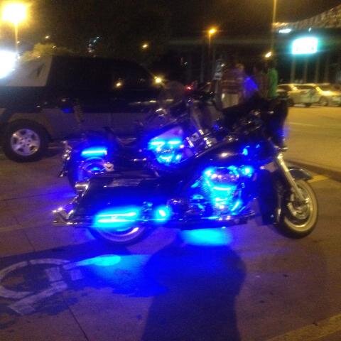

heres some:cool:
harley fatboy and streetglide.jpgharley fat boy right side.jpgharley fatboy and streeglide right side.jpg

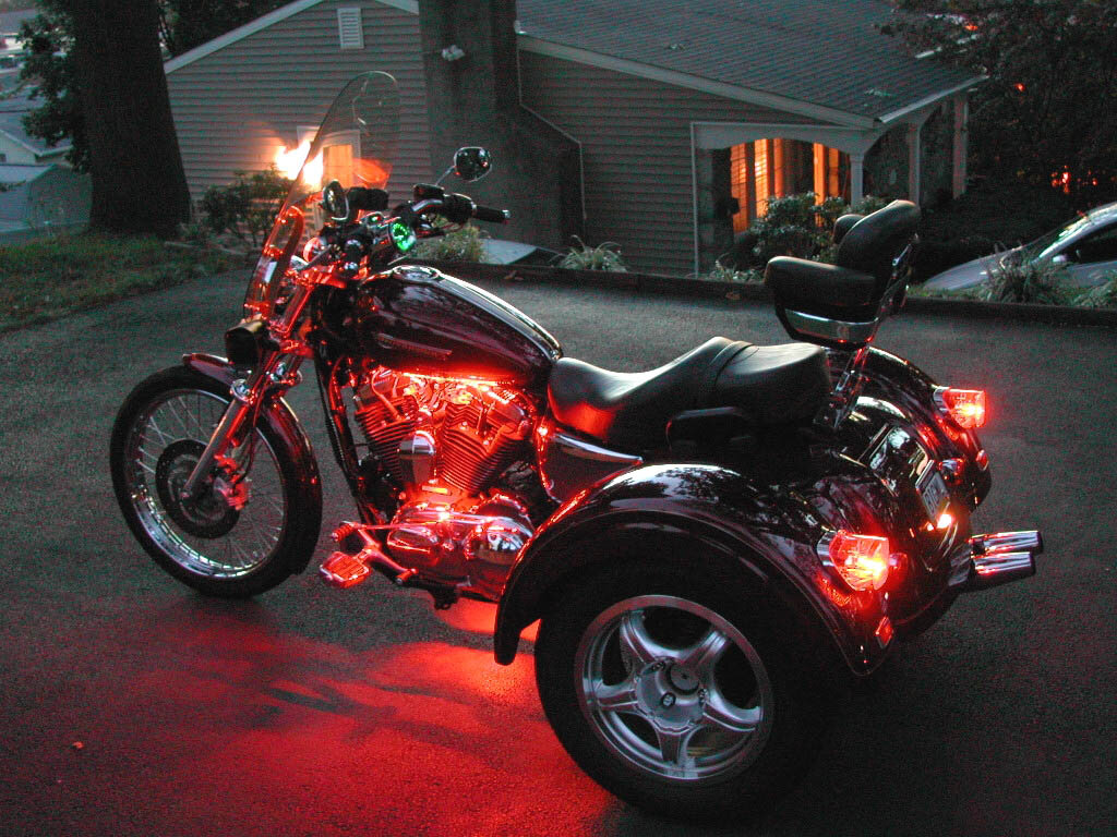

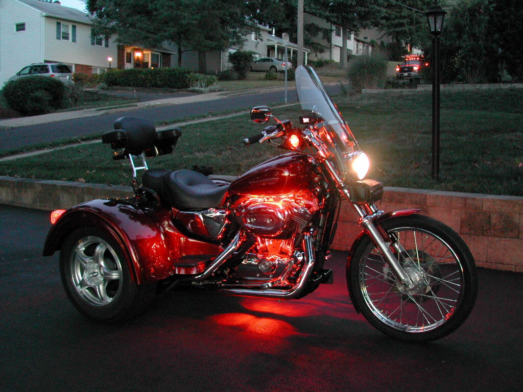

I installed LED lights on my previous Sportster-based trike. It got a LOT of attention at night.
I bought the parts from www.customdynamics.com, but there are a lot of other vendors out there, so shop around. Warranty length DOES matter ~ once in a while, one LED dies.
I didn't want to light up my trike like a Christmas tree (too many lights) or look like a carousal (multi-colored lights blinking on and off) After all, these are accent lights. I decided, early on, that I wanted to accent the engine, not the whole trike.
(2) strings "MagicFLEX 24 LED red lights 12 ~ 15" length under each side of the gas tank P/N MF24-Red
(2) 6 LED red modules (that point down at the ground, creating a "pool of light" under the trike.) P/N MF6ERDC
(2) 6 LED "MagicFLEX 6 LED red lights - one under the air filter case and one under the horn "cow bell" P/N MF6-Red
The thin wires were the hardest part. Remember, they're easy to mount with double-sided tape, but at some point, you're going to need to remove your gas tank and air filter canister. If you do-it-yourself, you're going to curse your installation IF you didn't add a few connectors to the light string. If someone else is doing your work (dealer, bike shop) expect to pay for an hour of labor time to un-wire / re-wire your accent light 'handiwork'.
Regarding the ground light modules, besides using the double-sided tape, I used black Ty-raps (2 per side) around the bottom frame rails, so they wouldn't fall off.

in the past I didn't like this type lighting on a bike, but after seeing the photos in this thread I have changed my mind, I really like the look of the Sportster Trike.ThumbUp
I have one question, is there any laws about driving with these lights on? With a small amount of cops out there looking for any reason to give bikers a hard time I would hate to spend money on lights that can only be on when the bikes are parked.:gah:
In Pennsylvania, as of 2015, the answer is No problem. In PA, all safety inspections are done by private garages.
Other states = YMMV, so speak to your inspection official before committing $$ to your project.
