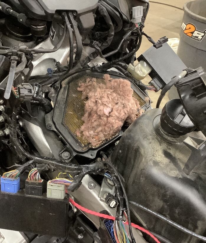

Just had the recall done at the dealer I purchased the trike from. They had it for a couple of weeks, no biggie as I have been busy with other things and the weather hasn't been great of course. While at the dealership I had them change the air filter since I'm not going to do it myself and had some concerns about critters and so forth. Good thing I did as evidenced by the nest they found.
I remember taking a piece of screen and molding it around the intake horns to the air filter on my 05.
Would that still be applicable to later models?
It would eliminate that happening in the future....
