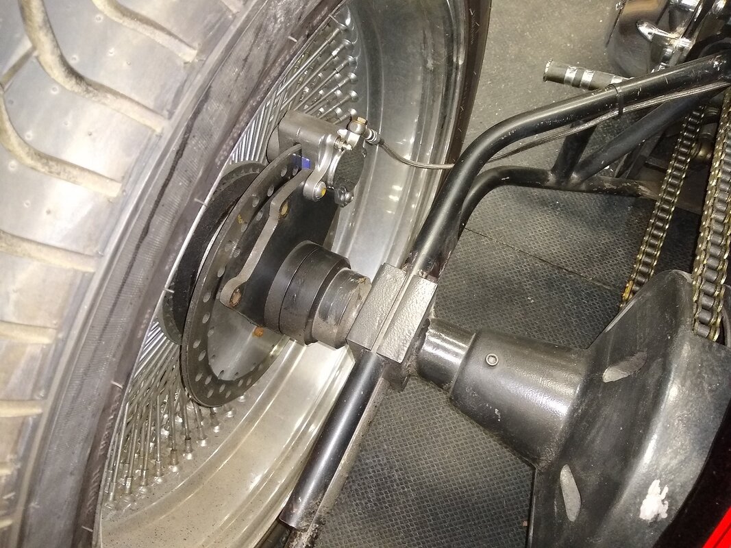

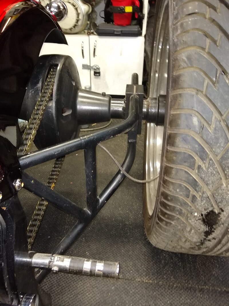

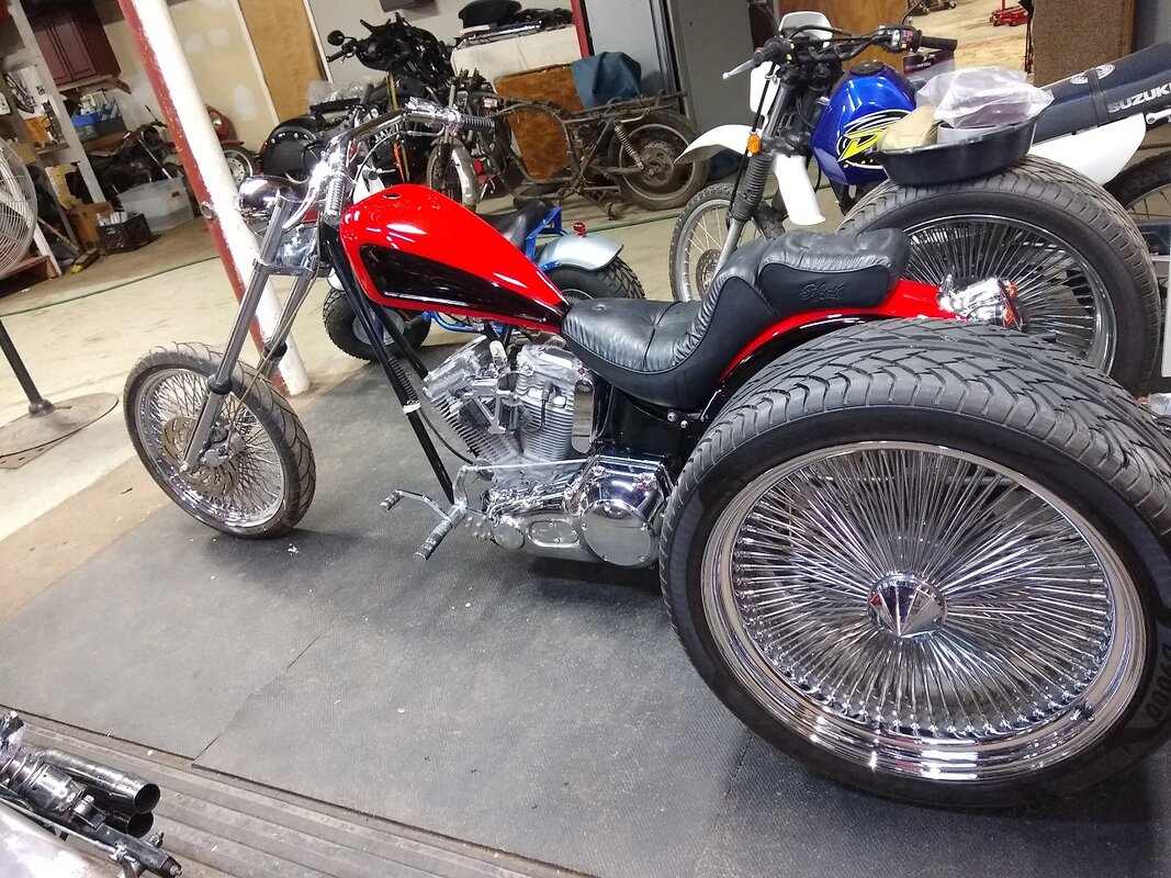

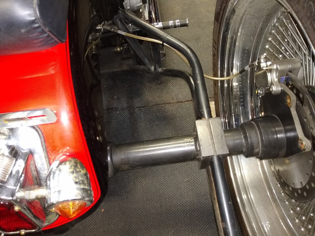

OK, so I ended up with this pretty cheap, and was toying with either putting it back to a 2 wheeler...because i have a swingarm and wheel set that would fit...
But also might keep it as a trike... Only not with those rear wheels (so dont bother flaming me for those...hahaha)
If i keep it, would do the usual 15 or 16, so I can get regular fenders etc.
However, I do have a couple questions, hoping someone knows the answers...
I am trying to find whose rear trike kit this is...only one I have seen so far similar, is the Frankenstein Trike Kits for Softail.
But those look like they have alloy spun axle covers (much fancier) than this one I have in pics.
So hoping someone will know so I can maybe just buy rear fenders to fit, rather than have to fabricate a set.

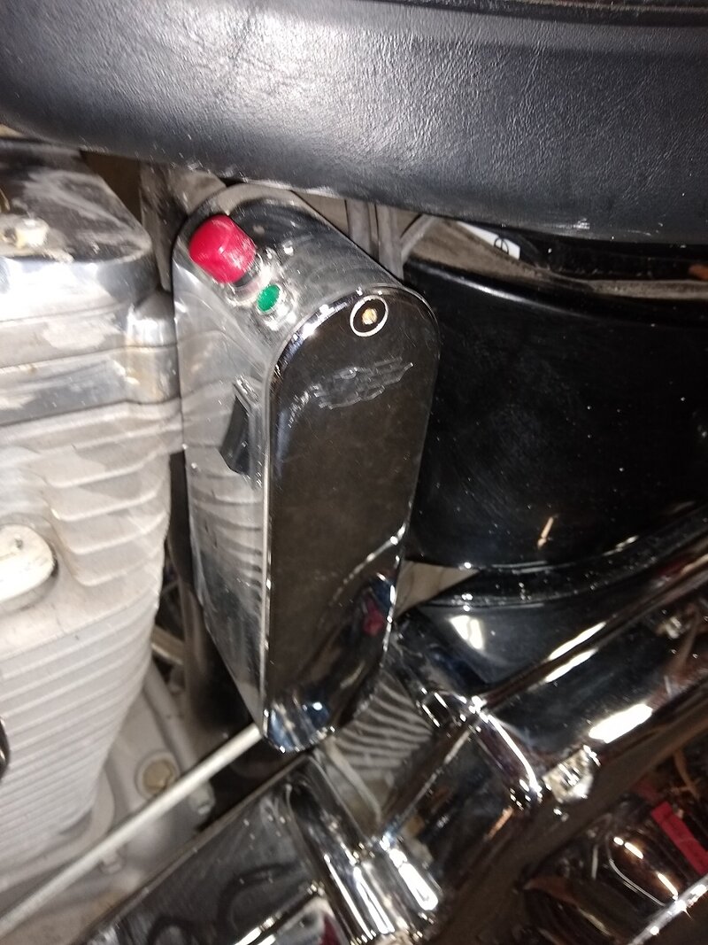

Also, cant tell what this little chrome box is (also in pics)... looks like either a starter box of some kind...(I assume, because I cant find a starter key or ignition of any kind... ) but had a couple people tell me it might be a air ride system.
I havent laid on the ground yet to look under... broken ribs... so hoping for an easy answer , before i have to start.IMG_20190820_184903172.jpgIMG_20190820_181440959.jpgIMG_20190820_181445018.jpgIMG_20190820_185016443.jpgIMG_20190820_185559359 (1).jpg

Green is a indicator light of some kind.
Red button is a push button, so I was assuming starter.
Rocker switch is on it also... so was figuring air ride up/down or power kill switch.
I see wires in and out...but no hoses, but I cant see anything behind this, so the wires look like they are orderly, so might be going to a power panel, and maybe have air hoses behind ...
I'm leaning towards it being some kind of power box/starter assembly.

Rear end appears to be a DNA. Mostly sold on E-bay. I think the rear end is durable enough, but I found the brakes to be inadequate. Hard to tell who made the mounts on yours.

Gota love a guy that answers his own question :clapping:Green light , ign on with rocker , push red , starter goes zoom , Simple starter relay under box. Doubt there is any air ride system. As it’s a simple trike set up. Heal up !
BTW, I like that thing , I’d leave it as a trike, and yup , those wheels are a little oversized and will screw up your low end take off. Could also be a early Frankenstein setup.
Thanks! Amazing how much more info I see on a search now that I know the DNA info. Really appreciated!
So looks like they have a decent rep etc... and I can handle upgraded brakes with no issues, I may even already have a set of PM calipers laying around.
But this will help me zero in on a fender system and sissybar assembly.
Thanks again!

With that much extension and rake, I bet you hardly feel the front wheel contact at all. That could be a good or bad thing depending on the road, speed, etc. Looks like a fun project. A fellow here in Salem has almost the exact same set up and it's a DNA kit. Fortunately he is not running airplane sized wheels on it...lol. Have fun with it and leave it as a trike!

Joe,
I believe you have a Santiago Chopper, or a copy of one. They are out of Florida and used the earlier version of what was to become the DNA rear axle. I think they fought with DNA over the rights. The picture below is one that I worked on in 2004 maybe. A VET bought it in Florida and brought it home to Baltimore. It had heavy fiberglass fenders and a steel 'fan mount' for the fenders. It is not a rigid but rode like one.

Thanks Jim,
Sure does look similar
And they have a phone number... Yea! (wont believe the number of places that dont want to field calls - emails only)
So I will call them to ask if they have fender mounts (Only see front fender mounts in website)
Thanks again for your help!
