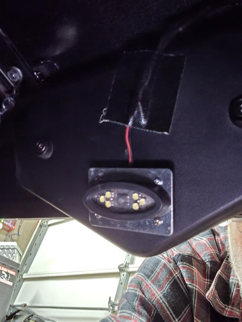

I posted this a while ago. It's a little time consuming but my take on it. Also did the same to the lower trunk.
Ok so I got tired of straining to see what was in the trunk at dark. Being a DIY kinda guy (ok, too tight to give HD another $100) did my own version.
Image 1: Purchased both items from O'Reilly Auto Parts. You can pick these up at most any auto parts probably. O'Reilly just my choice. The light pods (2 in package) were $15.00 and magnetic switch $14.00. I will use the other light for the bottom trunk just have to purchase another magnetic switch. Even then I am still under the $90 HD wants for their trunk light.
Image 2: Light has 3m type adhesive on back so I attached it midway of trunk latch. I tucked the wiring up in track with weather stripping to conceal it.
Image 3: Red arrow is wired magnetic connection. Green arrow is non-wired connection. Purple arrow is where wires are splice into luggage rack light wiring harness. Light will only come on when ignition is on.

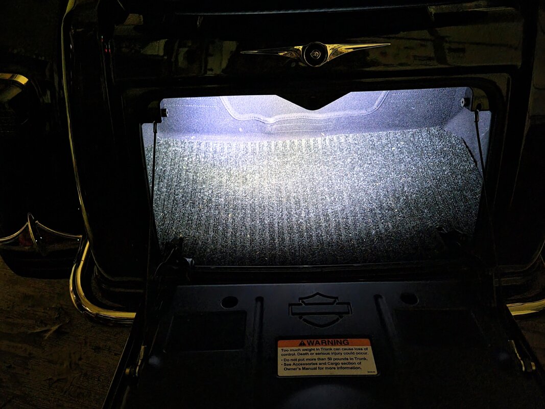

Image 7: Light on.
Image 8: Light on overall view.
