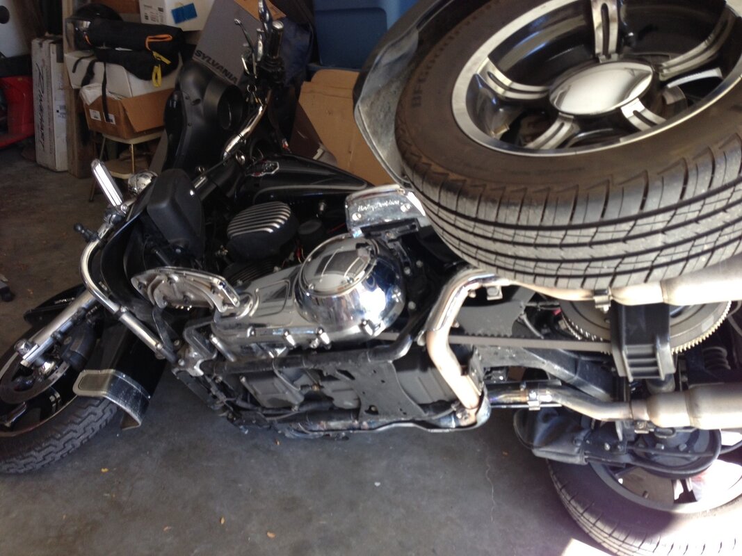

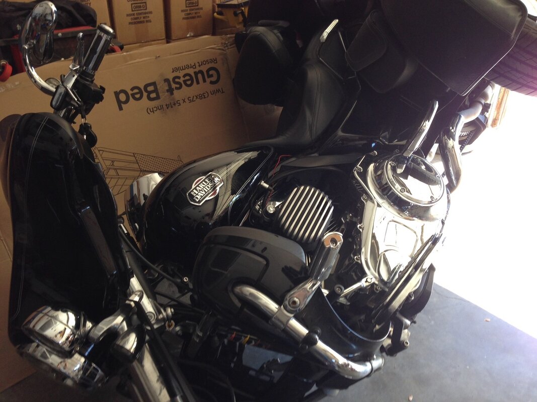

Be careful using a floor jack under the shock stand. I was attempting to put ramps under the back tires and figured one more pump on the jack would be just right........ as can be seen I had no problem getting to the slip-ons. Nothing damaged, just my pride, cause I had a bunch of boxes on the right side and the bike just eased over.
