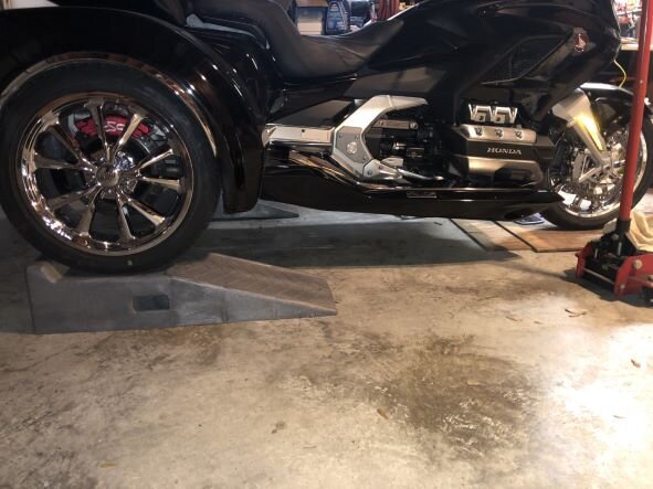

Good afternoon Y'all,
I am making preparations for the first oil change on my trike. In all the video's I have watched it shows the bike being lifted and level when draining oil from the 3 drain plugs under the DCT model. In the attached photo you can see that I backed the rear wheels up on ramps and left the front tire on the garage floor. This gives me plenty of room to work under the bike. Is there a problem draining the oil with the bike in this unlevel position or should I use my jack to raise the front end as well? TIA.

I can't imagine why you couldn't change everything with the trike sitting flat on the ground. I change mine on a lift but only because it makes it easier. To be honest I don't know about Honda Trikes.
I agree, When changing oil, filter, coolant brake oil. My trike sits flat in the garage
I have 2 sets of ramps and use 3 ramps and drive all 3 tires up the ramps.
Works slick.
I was considering buying another set of ramps and doing what you do. After watching a video of a guy who cracked his ground effects when driving down the ramps I reconsidered. I will have to check my clearance.

Thanks Ronnie,
I ended up leaving the rear wheels on the ramps and jacking up the front tire and placing two pave stones under the front tire. I removed the jack and the drain pan fit well with room to spare.

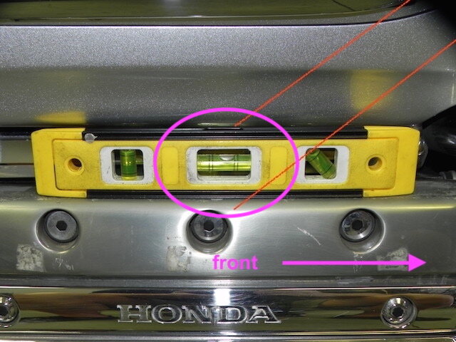

Hey Ronnie ... how are things.
As for your question, I have no idea. All trikes have a different forward/rearward slant or lean. For 5th gens, at my shop, on my shop floor, here is what we do. We take a stock OEM 5th gen Wing with a correct front tire and air pressure, and centerstand it ... on my floor. Then we lay a common 12" Stanely yellow level accross the right valve cover, and we look at the position of the bubble in the glass. We use the bubbles position as a referance. We do all trikes this way.
When a trike comes in for an oil change, we place the same level on the right valve cover and lift either the front or rear to duplicate where the bubble is for a 2-wheel. We the adjust the oil level accordingly.

For us the biggest problem with doing oil changes on trikes, is not the draining of the oil, but refilling them to their proper level. For example, when their ass-end is up like that, they can "over drain," and adding the "recommended" amount after an oil and filter change can be way off.
He we use a Stanley level across a valve cover to know. On our shop floor, we know where the bubble lands and a stock Wing, and "level" a trike accordingly.

Greg where does the bubble land? A picture would be great
I took this a long time ago and have no idea what the orange lines are for. But here we put the level on the righ valve cover and jack to get the bubble as shown.
I checked the oil today with my trike on a level floor. I put a level on the valve cover and the bubble was all the way forward. The level on the dipstick was right at the full mark. I raised the rear of the bike 3 inches to put the bubble at the same position as illustrated. The oil was very slightly below the full mark.
At the next oil change I will measure how much oil was drained in both positions and report back. Seat of the pants observation indicates, on my trike, that it won't make much of a difference.
Greg and Rob I found this interesting. I checked the level on mine and the bubble was all the way to the rear so I checked the oil level and then pushed the trike front wheel on a 2x6 I had and it put the bubble right at center rechecked the oil level and there is very little difference. So my opinion is if when checking my oil level I'll just keep it on the full mark, since there is a safety zone there that should be good.
Here are the results of my oil change on my 2012 Reverse Trike.
Since my trike is lower in the rear I drained the oil with it on the ground.
In order to get my trike at the same level as the one pictured I raised the rear of the trike 3 inches. And drained the rest of the oil. I got about 3 more ounces. I changed the filter.
I put 1 Gallon of oil in it while the rear was raised. After idling to get the new oil throughout the system the oil level was right at the full mark. I put the bike back on the floor and the level was slightly above full.
My conclusion, for my setup, is the difference between the two methods is minute. Not enough to go through the extra hassle.
