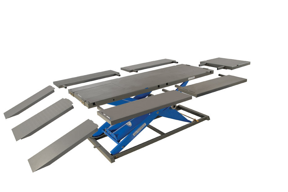

I have a '95 GL1500 SE with a solid axle Lehman conversion. I do all my own maintenance. We have averaged about 19K miles a year for the last five years so I do about 3 oil changes a year, not to mention cleaning and polishing, and I am getting too old and decrepit (sp?) to be getting down on my knees and back on a concrete floor so I have decided it is time for a lift table. So I would like to hear from you folks who have one which brand/model you have. Would also like to know what you like about it and what you don't like or would change and why. As always, TIA. Stan
I also never liked crawling all over the ground or getting up & down with my bad knees.... I started with my 1000# Handy bike lift before I triked then I added some 3/4" Plywood to allow my trike to fit.... was always having to help this rig up as it was about 300# over weight and no very stable as a trike / top heavy and not designed for this use.
When I retired three years ago it was time for a change that would not fall on someone and my riding mowers and mini Kubota along with the trike could be worked on in comfort. Enter my choice after looking at many different things / K&L MC625R Heavy Duty Air Lift : http://www.klsupply.com/SHOPLIFTEQUI...TYAIRLIFT.aspx
The website is full of information and has a video, Accessories available and a Manuel !!! I have found no trike that will not fit on this lift!!
I opted for the Air Version as they also have a Hydralic Model that seemed a little more messy and required more maintenance. It lifts 1750# so adding accessories is not a problem and at 500# it doesn't move around / I added the following and why I did...: #35-9926 Wheel Vise , #35-0321 Retractable Wheel Set , allows you to move the lift around, #35-6557 Front Extension , to allow extra space to pull farther forward and chok the tires, #35-6770 Nose Wheel for wheel set, #37-8660 Fat Jack , I use this for lifting the front from under the motor to access front pad changes for wheel removal - very stable, #37-9841 Center stand w/Adapters , for lifting the rear under the trail hitch area on my Roadsmith , also found one of these similar on EBAY - but this sissor lift will pickup the trike rear just fine for placing jack stands.
Oh and no more crawling around on the ground, work area is 40" to the deck and it locks when raising at every height click, has a little foot movable unlock to go back down. I use the same compressor I have used for years with a max. pressure of 120PSI but normally set at 100..
with the trike on the deck it takes less than 1 minute to get it eye level and locked at the top height. I'm so happy and confident with the lift I store my trike on it during the winter and address items that need work as needed. Today is oil change, tire pressures and grease ftgs day.... Friday the 13th
Whatever you decide get a little over kill, so it won't fall on you later...... FYI

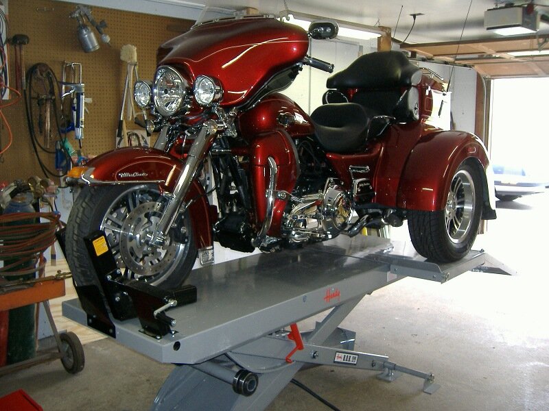

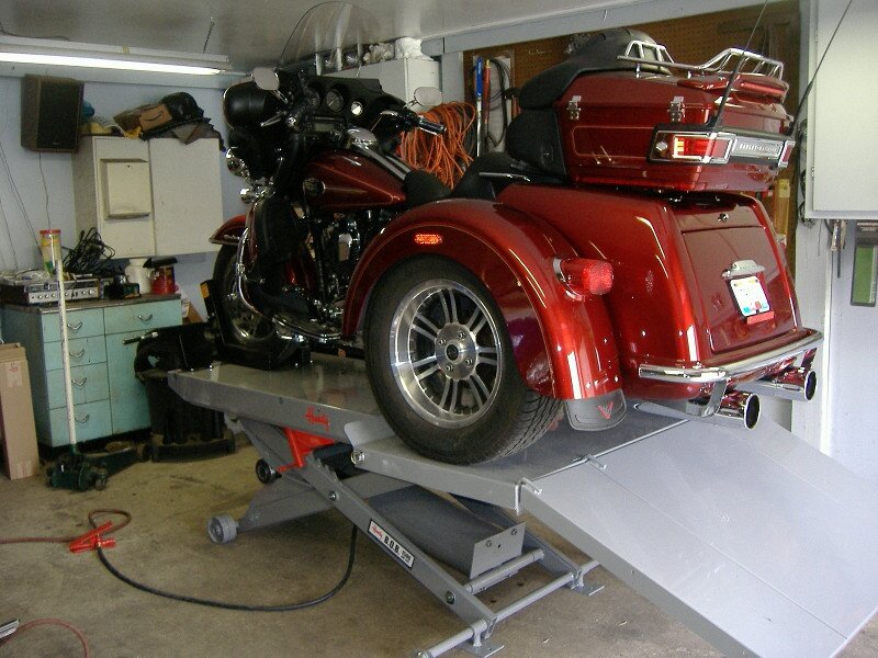

We had a direct lift before the Handy BOB1500, the Handy is twice the lift the direct lift was. Around here you see more Harley Dealers with the Handy lift than any other lift. The lift in the picture looks like the 1,000 lb rated lift, I'm using the 1,500 lb rated lift. There have been times I've really rocked the trike on the lift while trying to loosen a real tight fastener. I will say my 2012 Hannigan won't fit without using the chopper extension, which I haven't bothered installing.
The Handy I'm working off of looks more stout than the bent one in the picture.

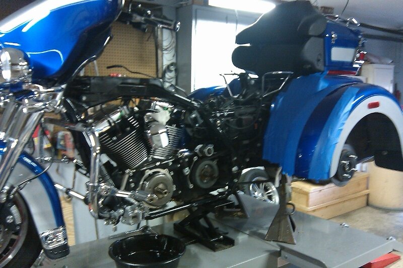

here is the lift table I got to handle my TG, there is a lot of things I like about this lift, but the best is that it will go up to 45 inches tall. I payed around $1250.00 delivered, when I lived in MO. You will find there are several sellers of this lift table and if you check around you should find a deal like I did.

I use a Handy B.O.B 1500 lb lift for my 98 GL1500 se trike and have never had a problem. You can buy an number of different accessories foe it also. Mine is an air lift and works smooth and lifts to 40 inches. It seems to be very stable. I just replace the rear axle seal and installed a new front tire on my trikes while raised in the top position and never had a problem. Sure beats bending over and crawling around on a creeper. Good luck on which ever lift you buy just remember common sense makes a lot of difference.:)
