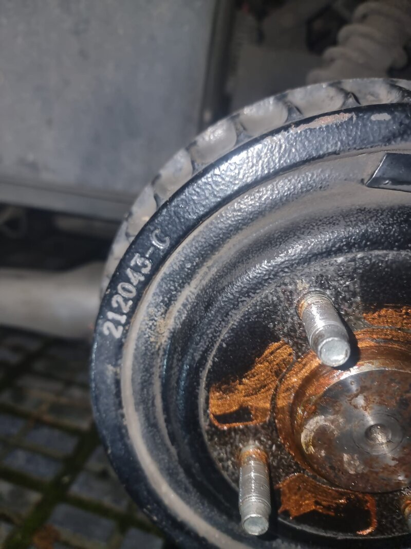

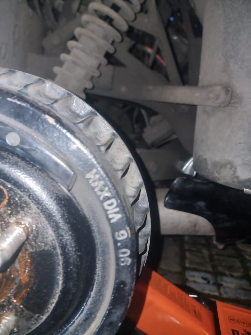

I bought the trike ,is any one able to identify what the brake drums are off its a 2000 1500 gold wing with a lehman trike
View attachment 110693View attachment 110694
Looks like a 9" Ford brake drum to me, even to the number 212043-C stamping ... and the fins. I just looked up a 1980 Ford Pinto brake drum but my '92 Thunderbird had the same rear brakes as do a lot of older Fords with drum rear brakes. You'll often see them listed as 1-3/4" wide or sometimes as 1.81" wide shoes. They did play with rear wheel cylinder diameters as a way of tailering them to application. I used to have a lot of info, but after I sent it back home to the original owner in 2019, most of it seems to have gotten away. I owned it 15 years though. If ever replacing wheel cylinders, might have to measure your's.
