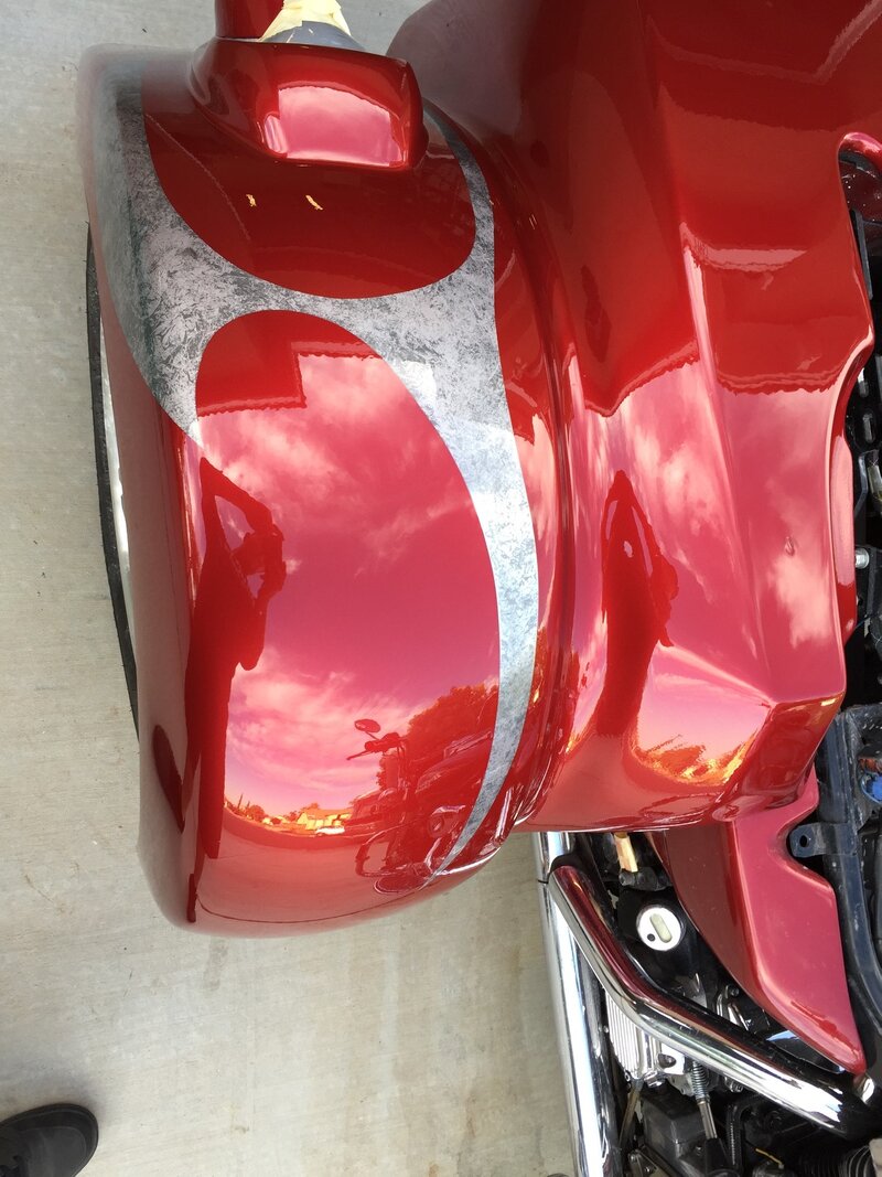

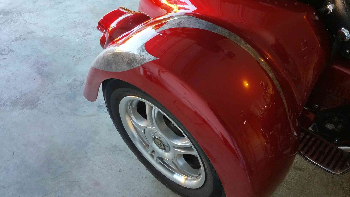

Trike Backed Into..

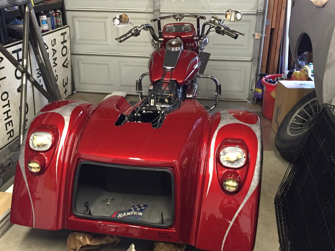

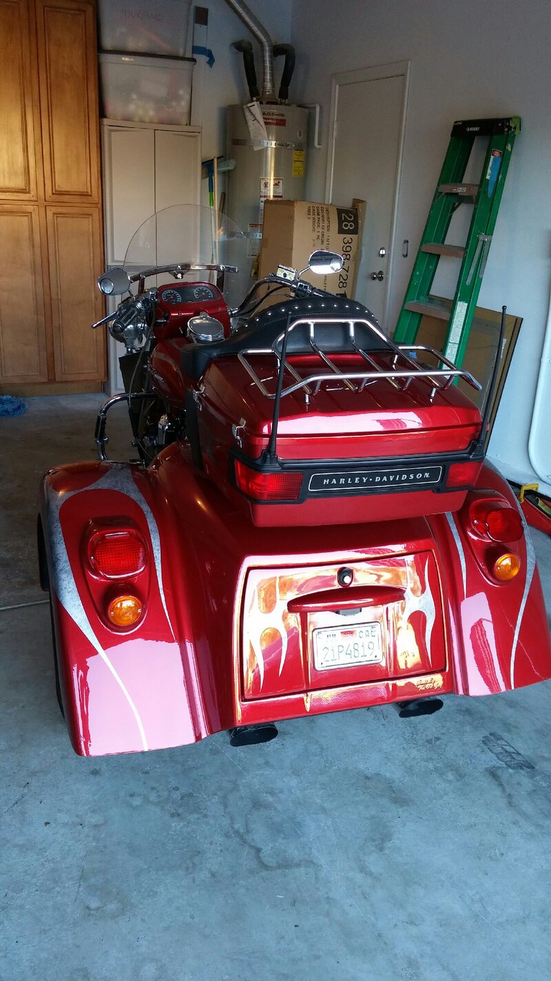

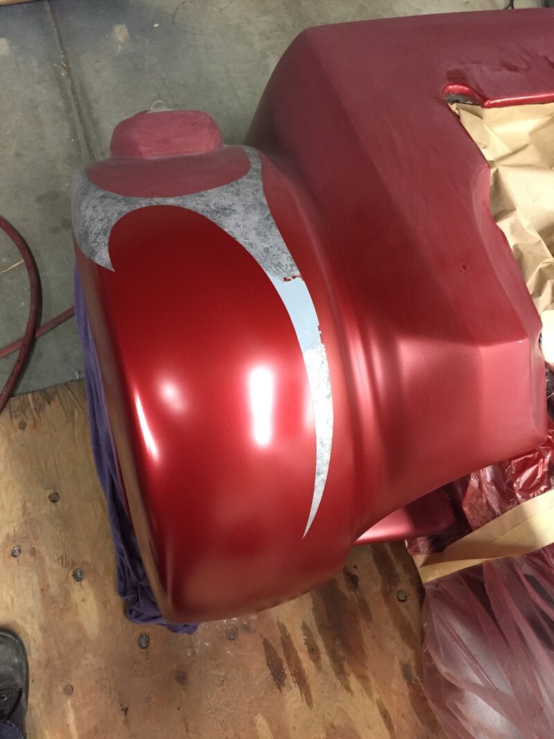

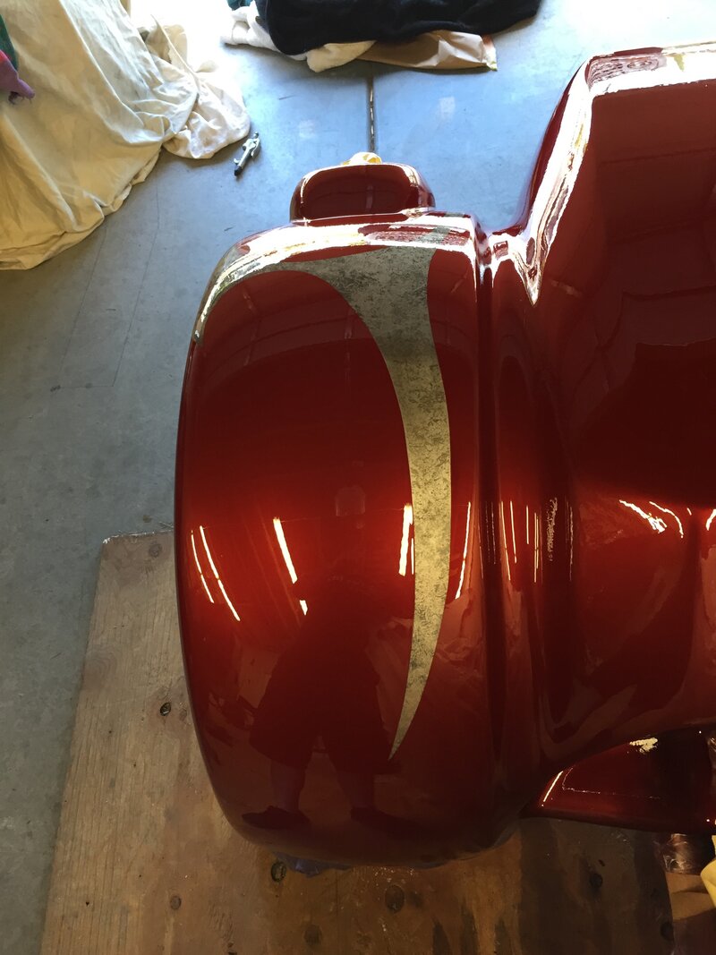

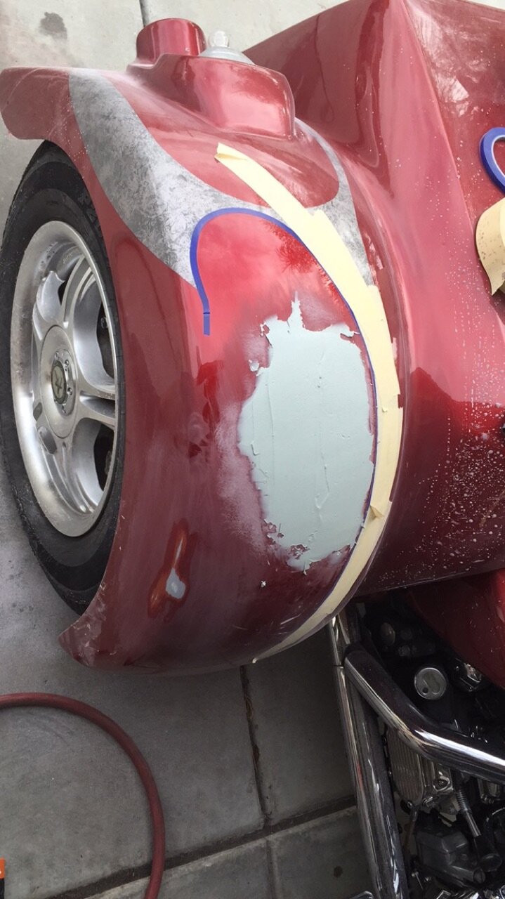

Tried this before I took it to HD..but seeing your post thought I should retry it. Took seat off hand pumped up to 50# started spraying and connection on elbow coming thru the trunk wall on the value stem Boom! Bubbles..carefully snugged fitting and bubbles stopped. Will let it sit over night and see. Thanks FuzzyWuzHe you got me back on track. Set the S&S back to factory and tuned it runs less rich and idle is right now, last thing I had was the air now I believe you fixed that. Tomorrow may be a great riding day. :pepper:
I get the feeling after being out of biking last 20 years. H-D feels its a rich mans game now. So even with my bad knees I'll have to do more wrenching again. Like you back in the day..I built some fine looking choppers thru 70 and 80's. Kind of miss the old school stuff. All this throttle by wire and EPA crap, don't get me started. Why I bought an older Trike wanted Carb, cables and grease. :)

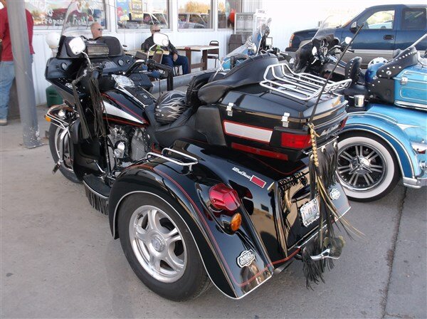

Thanks fuzzy, one correction though? The Tour- glide ultra and the road- glide are two different critters. Oddly enough I wasn't really looking for an ultra model but it would have cost me more to buy a plain Jane and set it up the way I wanted.
Harley quit making the Tour glide in 1994 wich is why I never bought another Harley over the years. I cant afford them nowadays anyway.
In 1989 I paid $12,500.00 off the show room floor and had to order it through the factory and be ready to lay out the cash immediately upon arrival or loose it and thought that was robbery! :laugh:
Well I guess I have gotten my moneys worth.
I wonder when Harley is going to trike the Road glide?

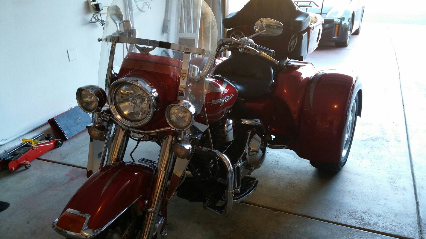

Wow just got back and see all the great info here now. Been busy riding with a big grin, spent a couple days going thru everything. Got the service manual every thing checks out fine so been riding a lot. Wife agrees " It's good to be back"..lol;)
Talking about co$t for fixing a D Trike. My ridin buddy has a 2014 HD Tri Glide got hit in the back I guess you can say quarter panel next to the trunk door. Women admitted it was her fault and everything. TOTAL co$t from ARROWHEAD HARLEY- DAVIDSON. $ 4980.00 Whole New body and trunk door with labor. Fenders were good as the rest of the trike. I KNOW a body shop would have been a WHOLE lot cheaper. But that what they wanted to do was let the dealer take care of it. No cost to them and only 3 days from dropping it off to pick up.
