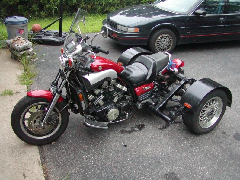

I did my Yamaha venture trike myself, think over things good before you proceed worked out fine. It was a tri-wing kit, only option I had, had to go though dealers for rest of kits.
Only caution some insurance company's won't insure it if not built professionally. I was never asked and never told who built mine. Someone on here had the problem.

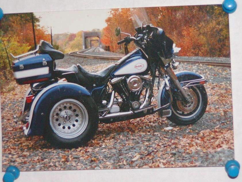

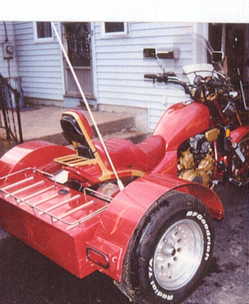

7984.jpg FROM THIS
palasades1.jpg TO THIS WITH A CHAMPION FLT KIT AND A FIVE DEGREE RAKE ALL BOUGHT FROM ZOOK AT A DISCOUNTED RATE AND DELIVERED TO MY DOOR.
BUILT BY ME, BECAUSE I WANTED TO DO IT MYSELF AND THERE IS NO ONE IN MY AREA OF THE GLOBE THAT KNOWS JACK ABOUT TRIKES.
FOR PICTURES OF THE CONVERSION AND A FEW HINTS TO SAVE YOU TIME AND HASSLE SUCH AS NECK BEARING RACE REMOVAL AND CONSTRUCTION OF ONE OFF PARTS DEALING WITH MY PARTICULAR 25 YR. OLD HARLEY- GOOGLE--(pcombe library/photobucket)
NOTE: THE FOLKS AT CHAMPION MANAGED TO SAVE ME SOME BUCKS ON SHIPPING AND WERE AVAILABLE FOR ANY TECH. QUESTIONS I HAD.
THE INSTRUCTIONS WERE PRETTY CLEAR AS LONG AS I DIDN'T TRY TO OVERTHINK THEM.
THE CHAMPION IS ONE OF THE MOST BASIC STRAIGHT FORWARD KITS TO DEAL WITH AND I AM VERY PLEASED WITH IT. THIS THE SECOND SEASON AS A TRIKE.
I HAVE ABOUT $8,000 INTO THE COMPLETE SOLID AXLE BUILD BY DOING IT MYSELF.
ALSO I WAS ABLE TO GET SOME TECH ADVICE FROM FORUM MEMBERS ANY TIME I ASKED.ThumbUp
YOU GUYS KNOW WHO YOU ARE BUT THANKS AGAIN.:cool:
