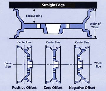

I can't remember the specs right now, but here is how to measure the wheel for offset.
Also try this information:http://www.crankshaftcoalition.com/wiki/Wheel_bolt_pattern

This is measurements off a stock rim I have off TG.
(now made in China, I thought they were made Down Under)
Overall rim width 6.5 Inches
Backspace 3.0 Inches
Front side to lug surface 3.0 Inches
So I would call it a +.5 inch offset wheel
4 lug and 4.25 spacing I believe
Well that's my story for now, sticking to it till told different.
