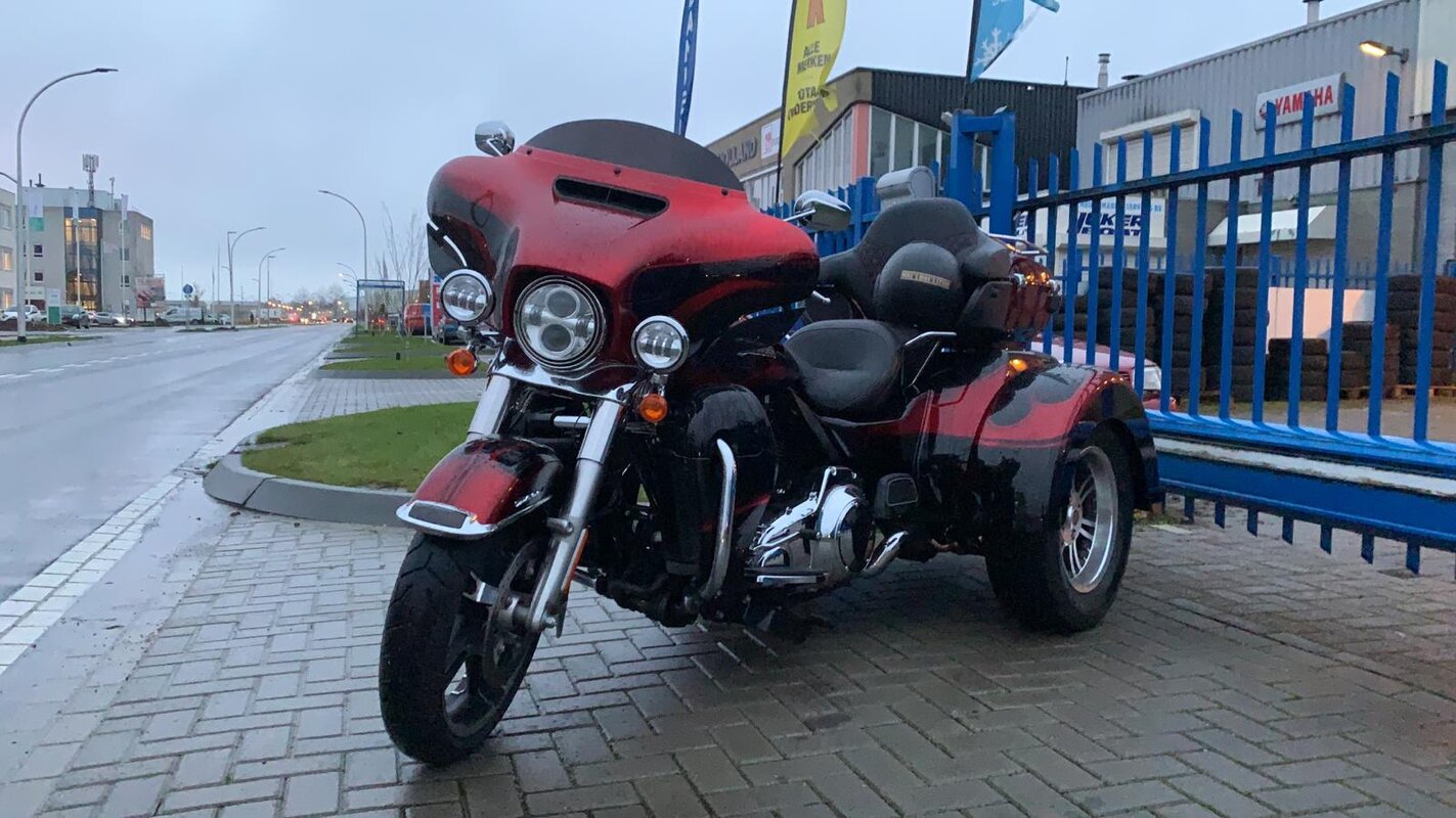

View attachment 82712Hi, I'm new to this forum. I recently bought a 2016 Tri Glide Ultra and when I turn on the radio only the front speakers work. When I go to sound options, the screen does not show a fader option. Its a stock Boom system. Can anyone help me please?
Here is your answer (At least this works on my 16 Tri)
Press Home--Press Setup--Press Audio Setup--Press Fade/Speed Volume-- Press Fade--adjust cross hairs so they are in the middle of the bike.
