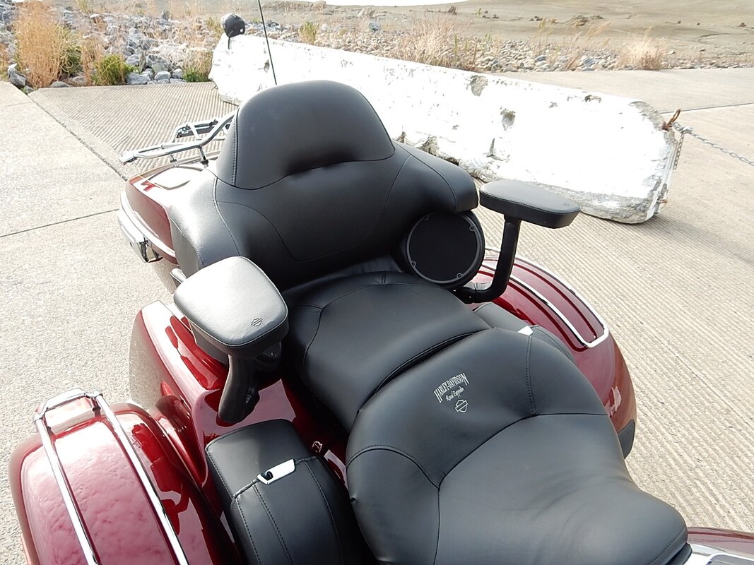

Just put them on mine last week. Remove the seat and tour pack, tape the template to the top of the body, drill 8 holes and then the fun starts! But only if you are doing it by yourself. You will have to remove the wheel on the side you are working on to reach up and hold the bracket plate under the body while screwing the bolts up into the block that holds the arm rests. Other than that, it is easy. It helps if you have someone to hold the block on top, for me I barely could reach both top and bottom at the same time but I managed!!!!:clapping: OBTW, while I had the Tour Pack off, I drilled new holes in it so I could move it back 1.5" for more comfort for the wife(and for my back rest to fit while both of us were riding!!!!)20160331_194910.jpg

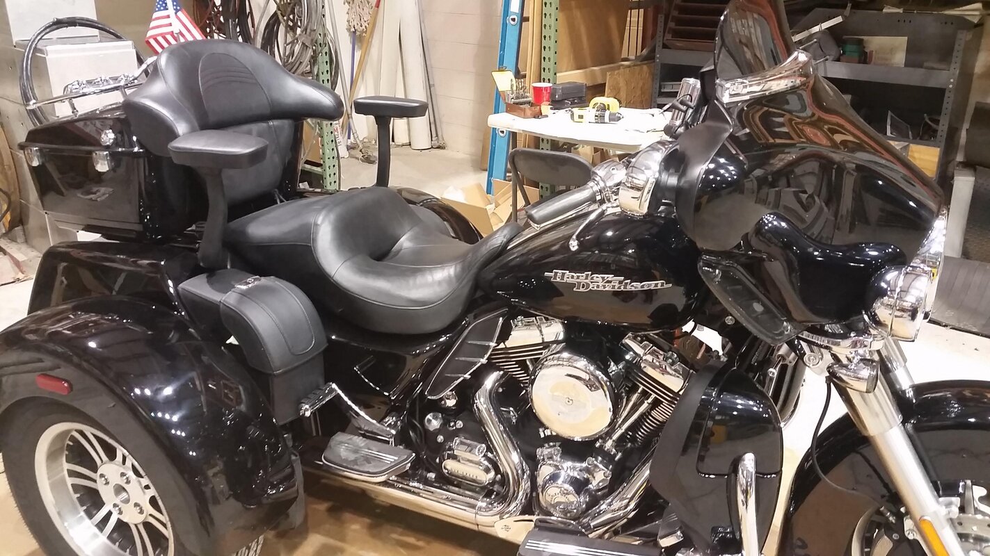

had the dealer install for me .. and we like them a lot put the garage door opener and key fob in secret armrest compartment ......
yes they swing .. out and also swing back --- out of the way if not in use
and they also swing all the way in to the front of the passenger back rest almost touching each other
no they do not "lock" in place .. but they do not flop around either -- well engineered and pricey
but "we are not here for a long time .. we are here for a good time" .. screw the costs
my co pilot is happy and comfortable :cool:
