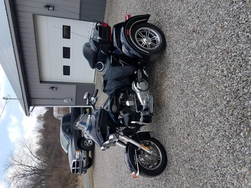

I removed the left side that gives the heat somewhere to exit. Passenger says it has really helped20190406_122848.jpg
