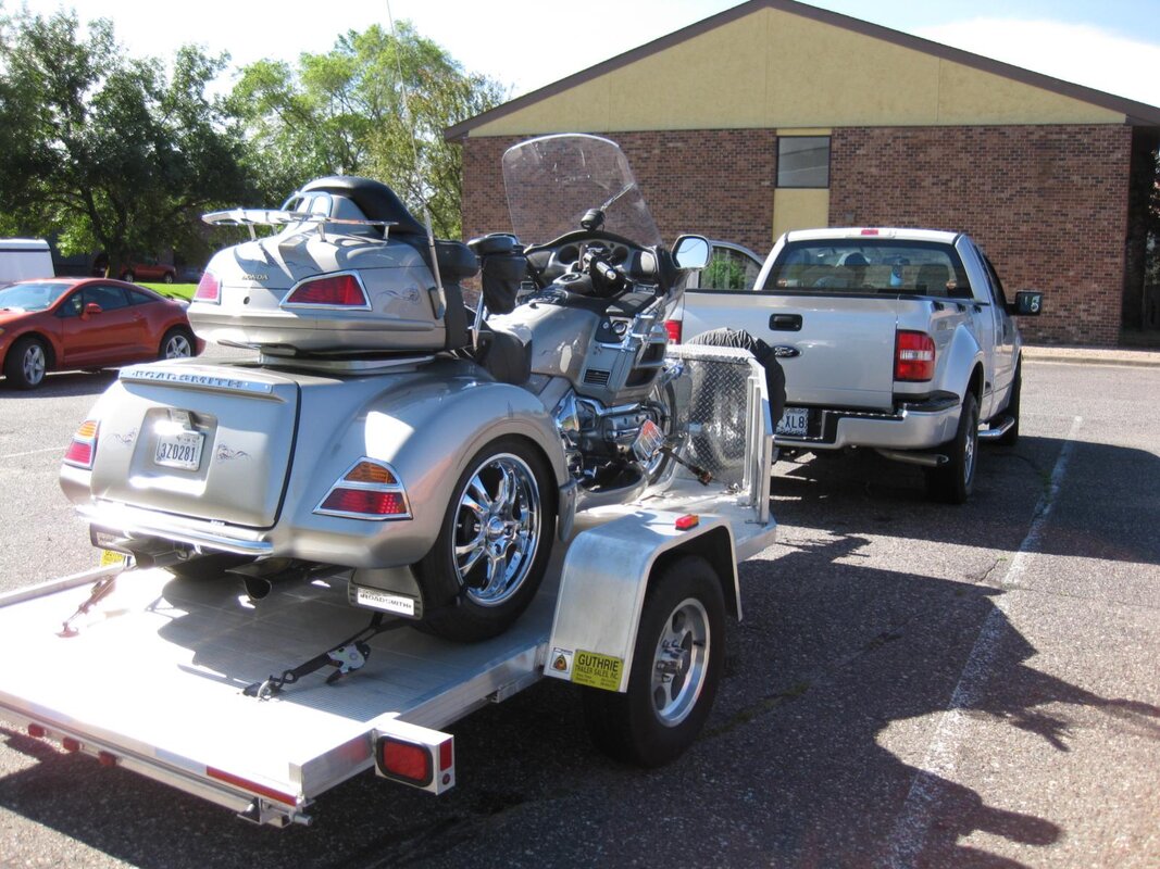

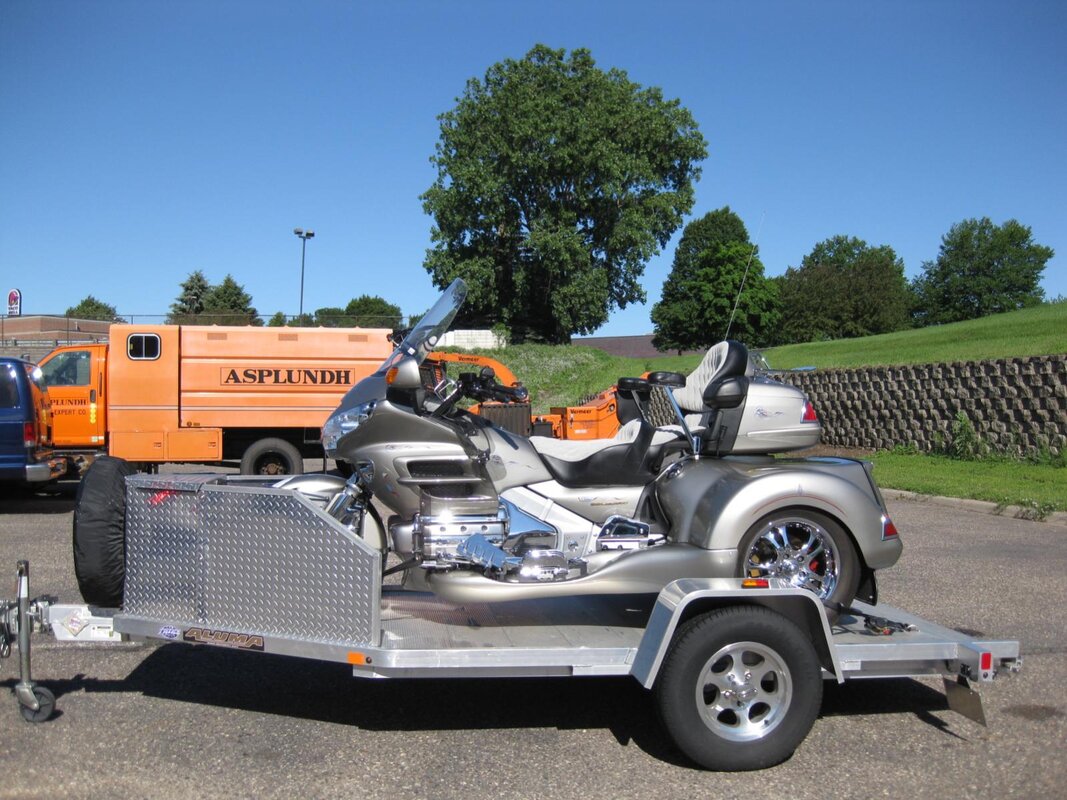

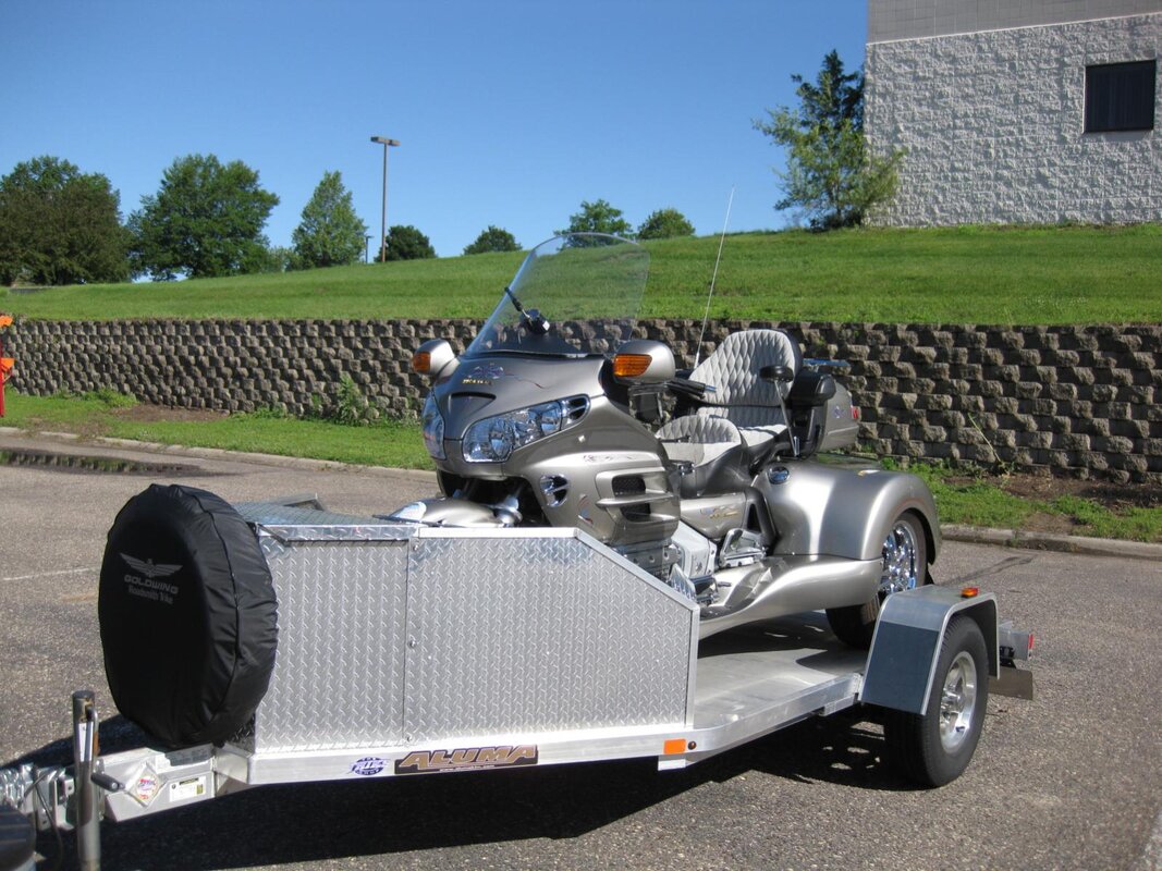

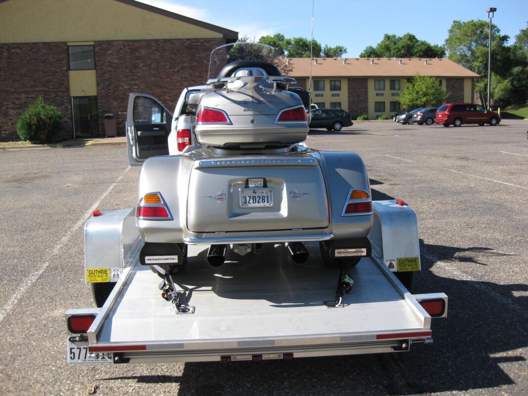

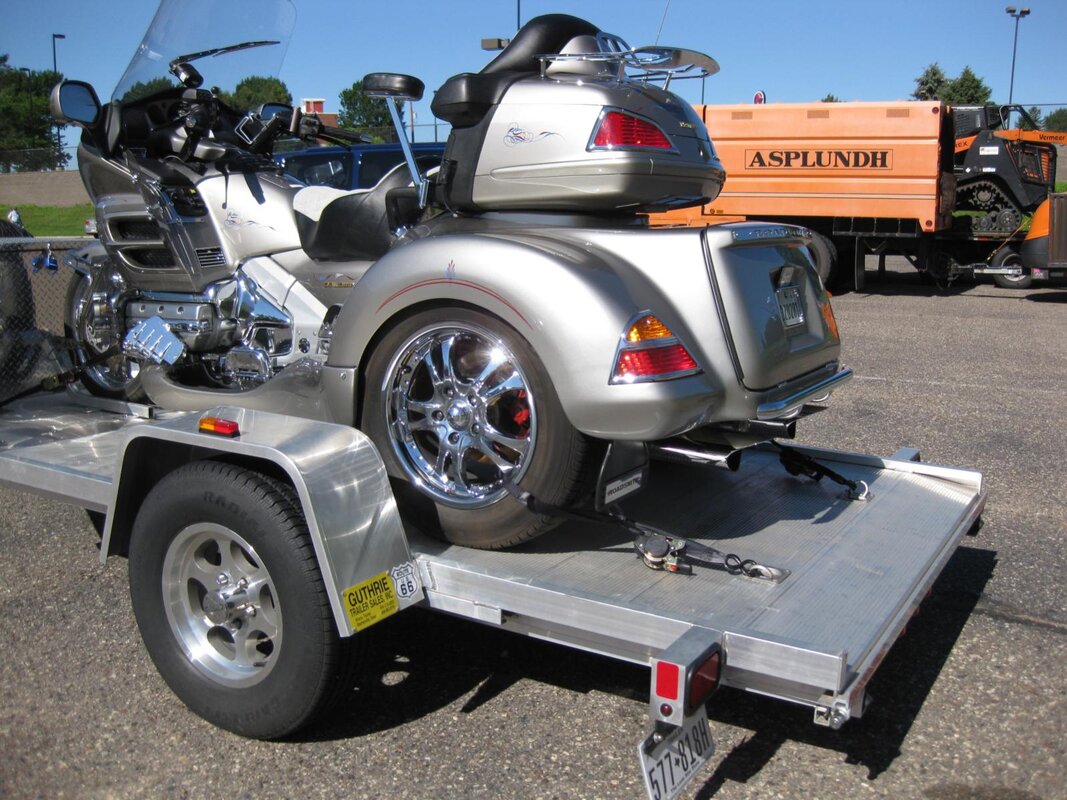

Aluma TK1 Trailer
This is what we use as we don't trailer the trike often but I use it a lot for hauling everything else. Trike, Garden Tractor, Kubota riding mower, building materials and anything else that will fit and you can move it around by hand. Plenty of room to walk around it and wipe the trike down and it comes with a stored ramp... Look around you can find them for about $2,500.00 then just water proof the nose box and mount a spare on the front of the box... great storage... pulls easy and straight!! Here's mine....with my Roadsmith.... when I was at Wing Ding.... during bad weather!!
http://www.alumaklm.com/item/49-tk1-trike-trailer.html Their website.....
