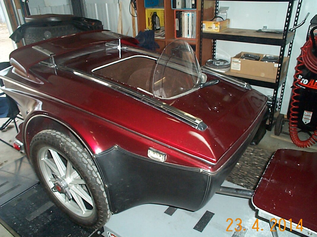

I just picked up a Bushtec trailer that I am modifying for my dog to come with me riding and wondered if anyone has any tips on routing the wire harness on my 2009 TriG...
I bought a Rivco hitch and it came with the 5 wire harness and the trailer is all LED lites..
The harness is plug n play on the bike end..Just curious as to the best locations to run the harness to the rear..
Thx in advance for any tips before I pull the left rear wheel and seat off the TriG..

Plug it in before the tail light converter.Run it down the wall of the lower truck to your hitch.Outside of the lower box not inside..wire ties it up and test
Note: you may need add load equalizer if the turn signals go into hyper mode.Because of the LED lights??
