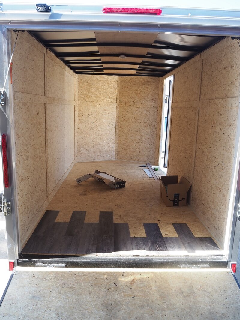

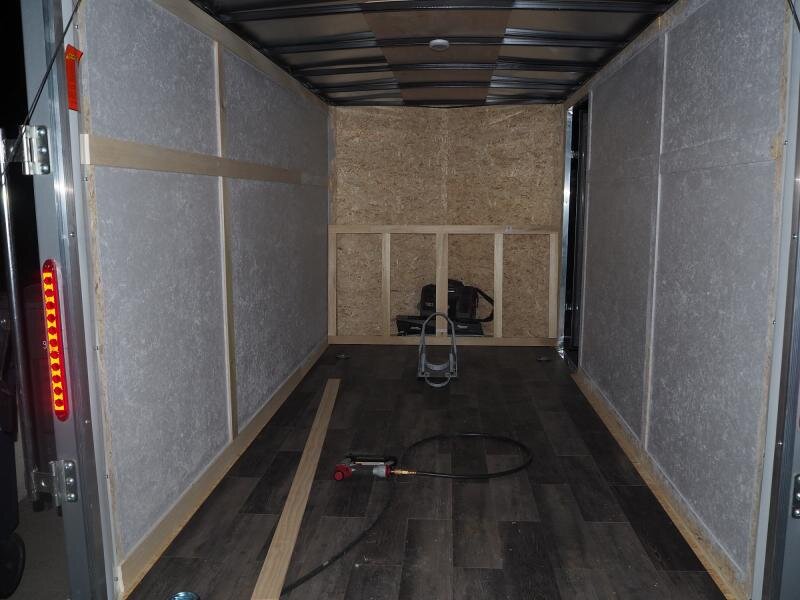

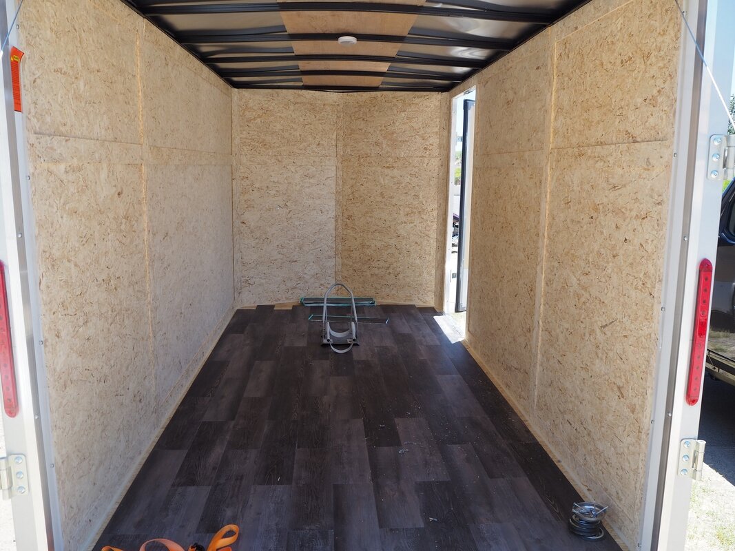

The first part of the project was to do the floor, mount the chock, and remount the tiedown rings.
I chose an a peel and stick vinyl tile.
It is pretty tight between the cables so I got a couple of pool noodles (not pictured).

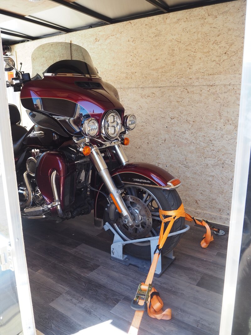

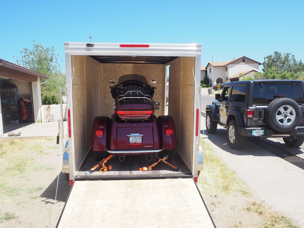

This seemed like my best option for tying down the front. I didn't see any place to put any tension on the ratchet straps so this seems to work.
Next on the list is wood trim for the floor along the side. Metal edge for the rear and cabinets for the front.
More Later.

Just a heads up.....I strapped my front wheel on my 11 Tri like that...And the strap abraded/scarred the wheel....The next time i had to strap the wheel i put a soft towel between the rim and the strap so it wouldn't happen again...
I usually run the straps around the fork tubes just above the bolts that hold the fender on each side.
Work great!
Good point. I also use towels between the straps/soft tie loops and the metal when securing.

I agree with using towels on the wheel before wrapping your tie down around it. Most wheels have sharp edges or flaws that WILL cause that nylon strap to fail. Better yet, use soft ties around the triple tree and tie down from there..... Jim
For the front I use the soft ties around the fork lowers (at the fender mounting point), and I use towels between the soft ties and the metal.
Did you mean the fork lowers or the triple tree?
I have always used soft ties from the triple tree. Then ratchet straps to the trailer corners forming an A figure. Ratchet the front fork to about 50% compression. Never a problem..... Jim
I have some straps with built in fur padding that I attach around the fender supports on the fork tubes then I ratchet forward pulling into the chock and compressing the shocks a little

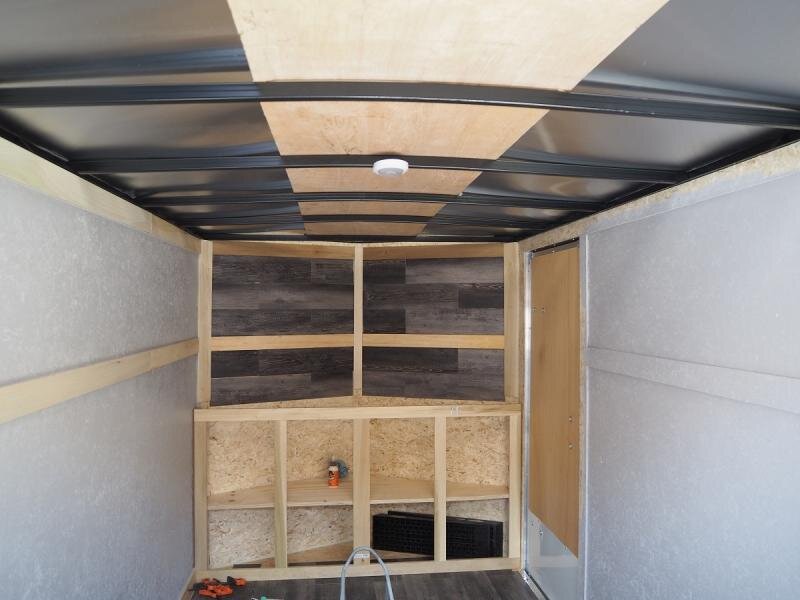

I am thinking I am about halfway there. Installed the face frame and shelf. I had exactly enough floor tile left to do the back splash. Did more of the trim.
Still need to build cabinet doors, finish trim, build the counter top, repaint in a different color and sand/finish trim. I figure two full days of work left.
