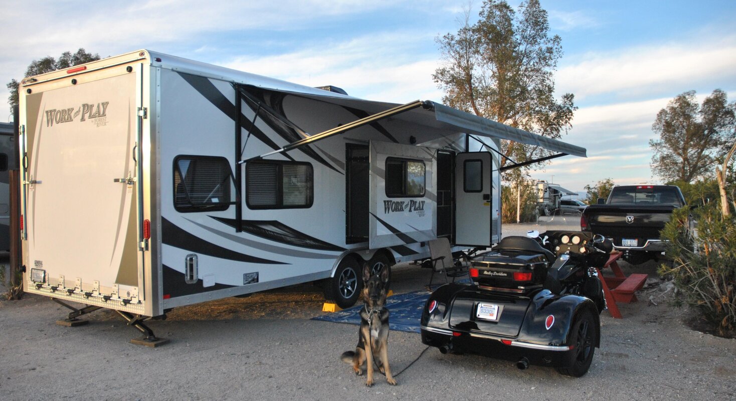

Work and Play. In Jan-Feb we did 37 days, 6300 miles in ours. It performed wonderfully, and is a welcome addition. Ours is a 30WRS, its got a 10' x 8' garage with a patio door separating it from the living area. The garage converts to living area once the motorcycle is gone: fold down couch and dinette.

I recommend that you load your Trike onto whatever Toy Hauler you consider buying prior to purchasing it.
I had salesmen tell me that there would be no problem with my Triglide bottoming out when loading with a couple of Toy Haulers I was considering buying- WRONG !!!.
I have a Work and Play that just barely clears my Trike. Also, if you consider buying a Work and Play, stay away from the chain drive lift bed (sleeping).
Regarding bottoming out: I usually put the trailer nose up, which decreases the angle of the ramp. I also use two 2"X8" ramps that I run the rear wheels on to access the ramp itself. One or the other method, alone, would probably work...
Also, I agree on the bed in the garage. We did not go for this option, as it really decreases headroom. BTW, our Work and Play has 7' ceilings...great for a 6'2" guy!
You're right about raising the nose before unloading the trike, I forgot to mention that.
Re the chain drive sleeping bed, it's a poor design. The entire frame bends (its supposed to be designed for up to 300lbs support. Dealer replaced complete bed support & it happened again). Plus you need a parachute to get down from it and a step stool in get back in ( not so good at 2am for going for a pee )
