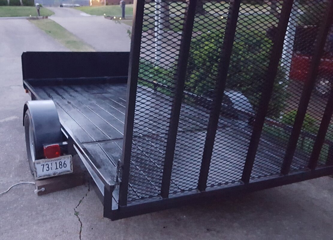

I'd buy the Dovetail and have them put the Taller ramp on it. I had mine built like that....works great. Also had them add a short {ish} stone guard. jc

Sorry...but other add-ons.... I had them run angle Iron under the deck where I was going to bolt the chock. Gives me a solid mount...And had them add other bars to the ramp where all three tires hit...again, maybe a bit over cautious...but peace of mind. you can see the better supported ramp in the pic.

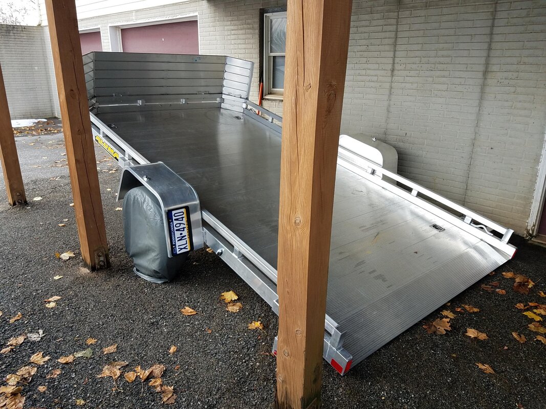

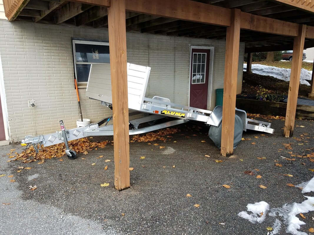

We bought an Aluma 7712H tilt trailer after my wife decided she wasn't up to long distance trips riding in bad weather anymore.
Dove tail is best choice. Your mufflers are close to the ground. The regular trailer will be a steeper (higher) ramp. Dovetail makes a smoother transition to deck.
I would go for the dovetail model. It will make loading easier especially with a longer ramp.
That is a great looking trailer...and surprised you don't drag on the way in or out...and being aluminum...nice and light.
jc
Thanks JC... I have to two short sections of 2×12 I lay down for the rear wheels just to make sure the pipes don't drag if we are loading/offloading somewhere the pavement is not level. The tilt on the trailer is 15 degrees and is usually ok.
