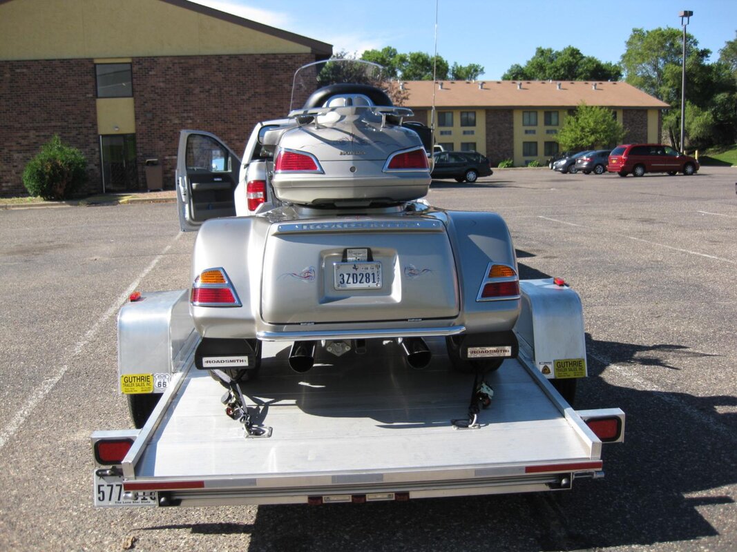

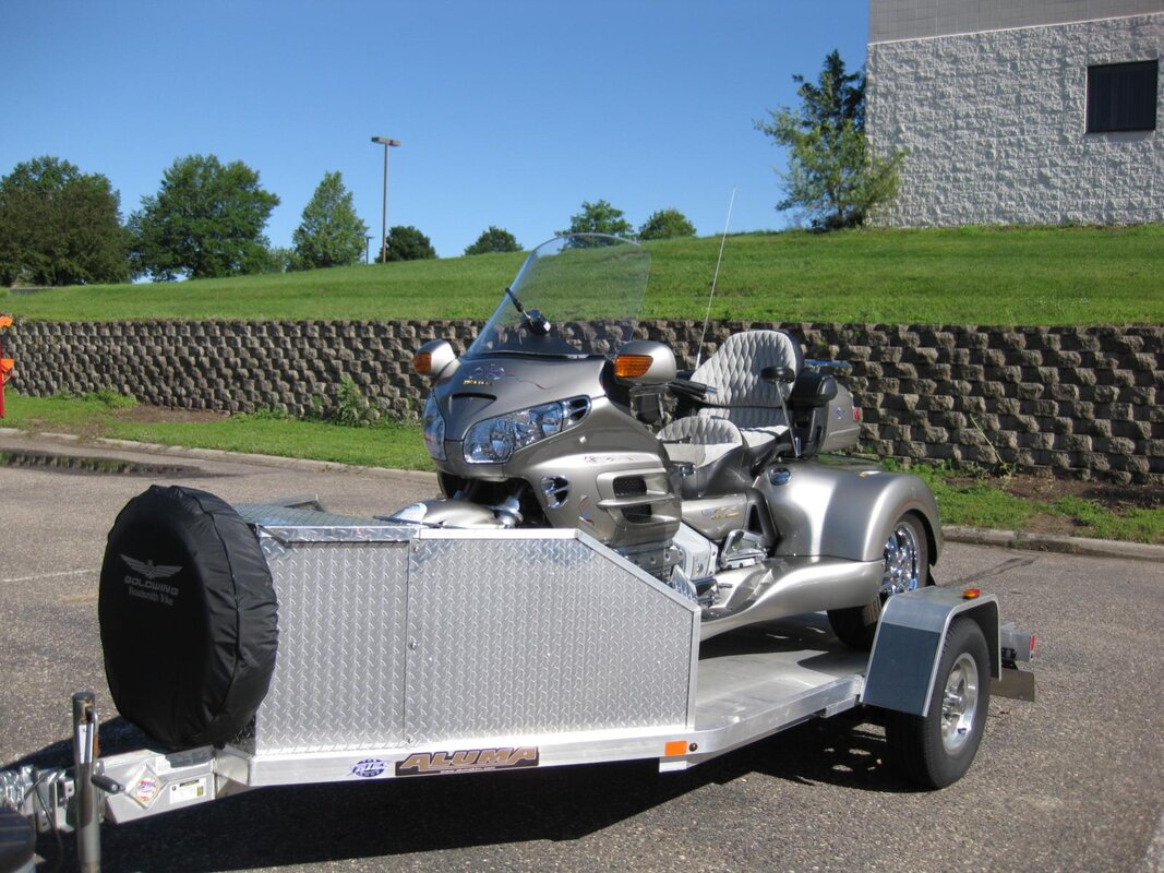

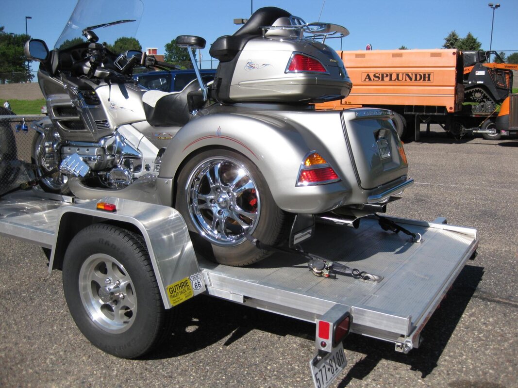

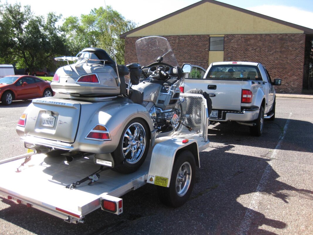

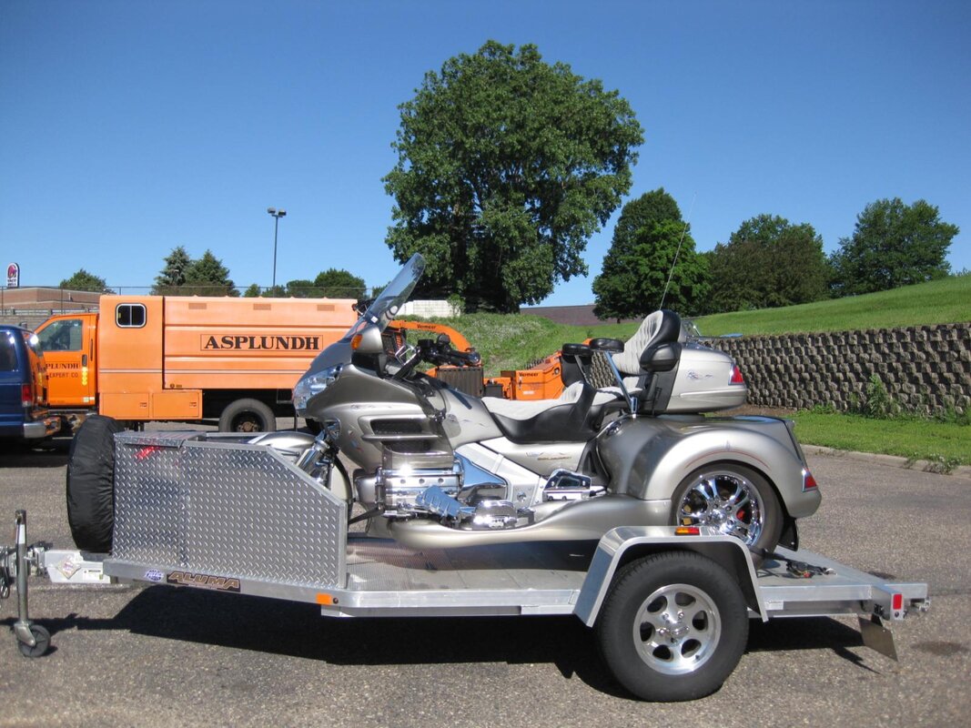

Mine is an Aluma TK-1 Trike Trailer and is perfect, I waterproofed the front storage box except at the bottom to allow it to breath. I use quick ratchet straps so there is no extra strap material. Perfect fit and puts the weight in the right place for towing. The ramp is just right but I changed the spring loaded pins with pin / hitch locks so the ramp doesn't walk off.... Mounted the spare on the front for easy access and is locked on inside the storage box.. light and easy to move around....

Of all the trailers I've checked out, that one makes by far the most sense in construction, weight, usability and price. And besides that, it's simply good-looking!

How wide is it and how high off the ground. My Hannigan is 63 inches wide
I also have an Aluma tk1 trailer. My 2010 gl1800 Hannigan fits perfectly. I have pulled it from Ohio to Arizona to Texas to Ohio and back multiple times with a GMC Yukon without any problem. My biggest problem is remembering it's back there!!
How wide is the TK 1? From what I saw on the website, they are as expensive as an enclosed. Are they out there for less than 3 grand?
The Alumas are on the "high side" for an open trailer but in my opinion, worth every penny and one of if not the best designed and made.
Hannigan GL Trikes are 61.5" from extreme fender edge to fender edge.
I own a 2012 Hannigan and it is about 63 inches wide. I meant how wide is the Alumas?

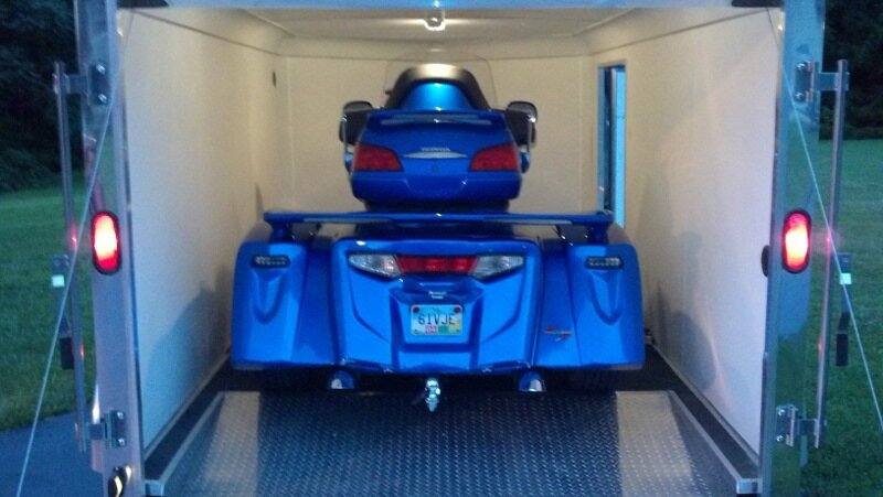

This is my GenII Hannigan in a 7x12 Haulmark V nose low hauler.
If your going with enclosed you do need room to get to the tye downs and around the trike... if its to close and its not tyed correctly you may be missing some paint when you get to your destenation / my enclosed is 7.5 X 14 with a truck box in the front for storage.... but I really like the TK1 Better / you can see what you have without climbing inside... and its about 1/3 the weight!!
