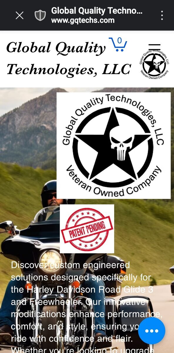

Yes ,you can have a tour pack on your freewheeler flrt !

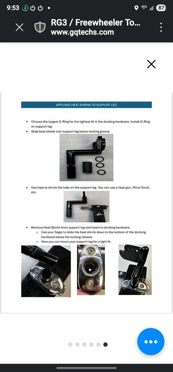

It also flips up toward the driver's seat too allow the trunk to be open. Then flips down to resume normal position. This is a manufactured bracket that slides right into your backrest brackets and locks down the same way. So it's removable, does not come with a tour pack purchased separately. Whether it's a razor, chopped or King tour pack.
I like advanced products color matching tour packs. I have custom paint so I have to get a color match a black quartz.
So the answer to your question is it is very possible, bracket is somewhere around 550.00 approximately.
