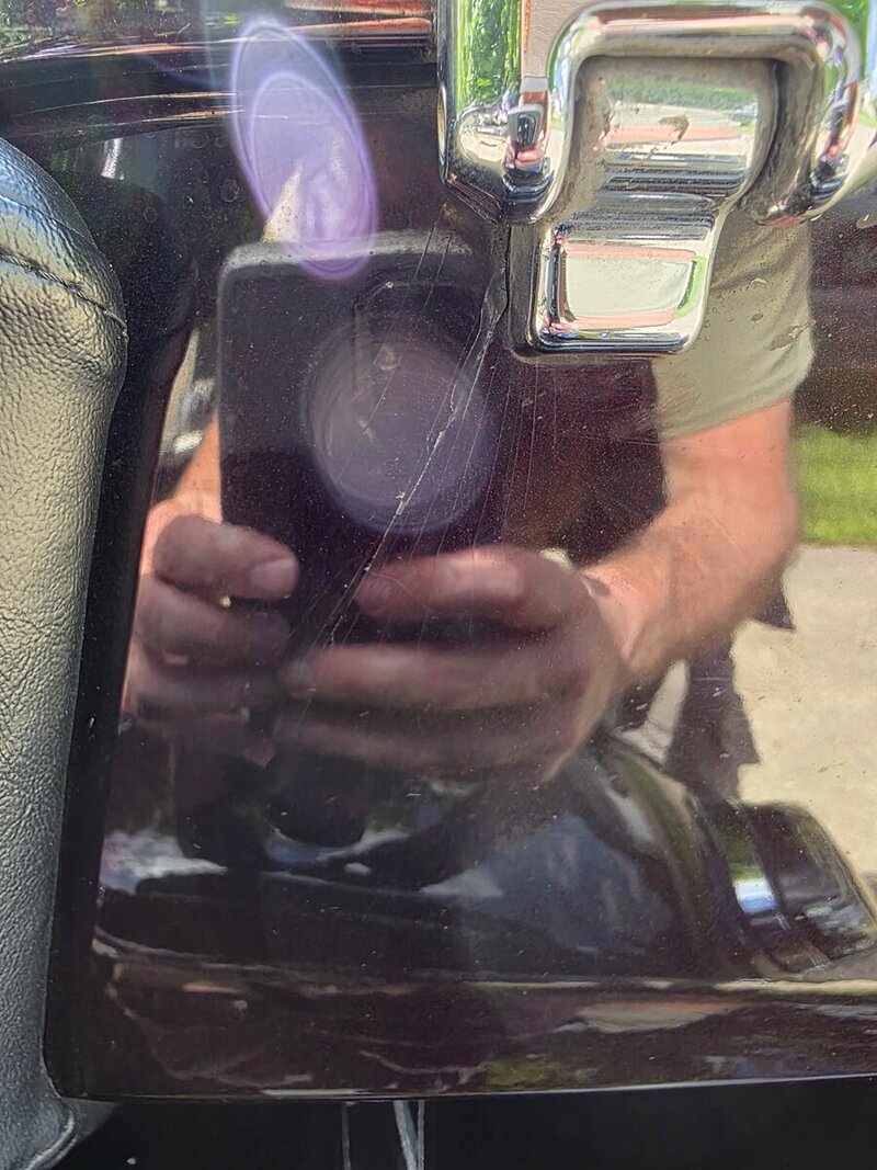

Hello, I apologize that this isn't really "off topic", but since I figure more than the Tri Glide uses the King tour pak, I wanted to ask this in the general forums.
I had just finished a few hour ride with some friends, and noticed that my tour pak had cracked right at the hinge. At first I thought it was just the paint, but upon further inspection, the crack goes through the entire box. After some expletives, we decided to drill a small hole at the bottom of the crack to hopefully keep it from expanding further.
The picture is pre drilled hole, and is dirty from the day's ride. I am guessing that I have to buy a new lower part of the tour pak, unless anyone here knows a way to fix it? Also, my question is, once I get it replaced, is there a way to keep this from happening again? I am assuming that the lid flexed it enough to break it, and maybe some vibration while riding it. The pak is from a 2014 Tri Glide, so it might just be aging. I have the stock tether on it, and had figured it was enough support for the lid, but maybe not, after seeing this. Will the cable tether from Harley keep this from happening on the next one I get? Or should I MacGuyver an aluminum plate on the next one to distribute the load?

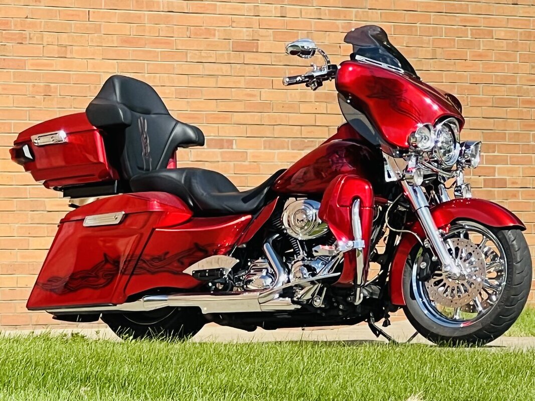

@Vod , unfortunately I’ve heard of this problem more than once. Personally, over the years, I’ve never had this experience, but it’s a problem that has indeed been blamed on the tether.
I’ve had aftermarket tour packs too (AdvanBlack makes a good one, among a few others), but I have always added a product from: eGlideGoodies and it’s called the ULTRA BRACE made for HD Tour Packs.
You can purchase direct, or JP Cycle & Dennis Kirk. I’ve also seen them on eBay, but have not seen them on Amazon.
Now: The price on this simple bracket/brace is $80.00.
Many (including myself) have looked long and hard and checked with local hardware stores to try to find this cheaper, but to no avail, we all came back to only buy this brace that seems to be a proprietary item.
But I will say, it works GREAT!!! And it keeps that Tour pack lid in place without overextending.
I still kept the OE tether on it, but is basically just useless now as the Ultra Brace takes over.
There are also YouTube videos on this too.
My best advice for you is to get the replacement Tour pack bottom (or buy a complete tour pack through the aftermarket) add this brace and you should not only be problem free, but you’ll like it!
This is also perfect for when you have some luggage/weight on that upper rack and will not twist or tweak the hinges either. Well worth it, in my opinion!

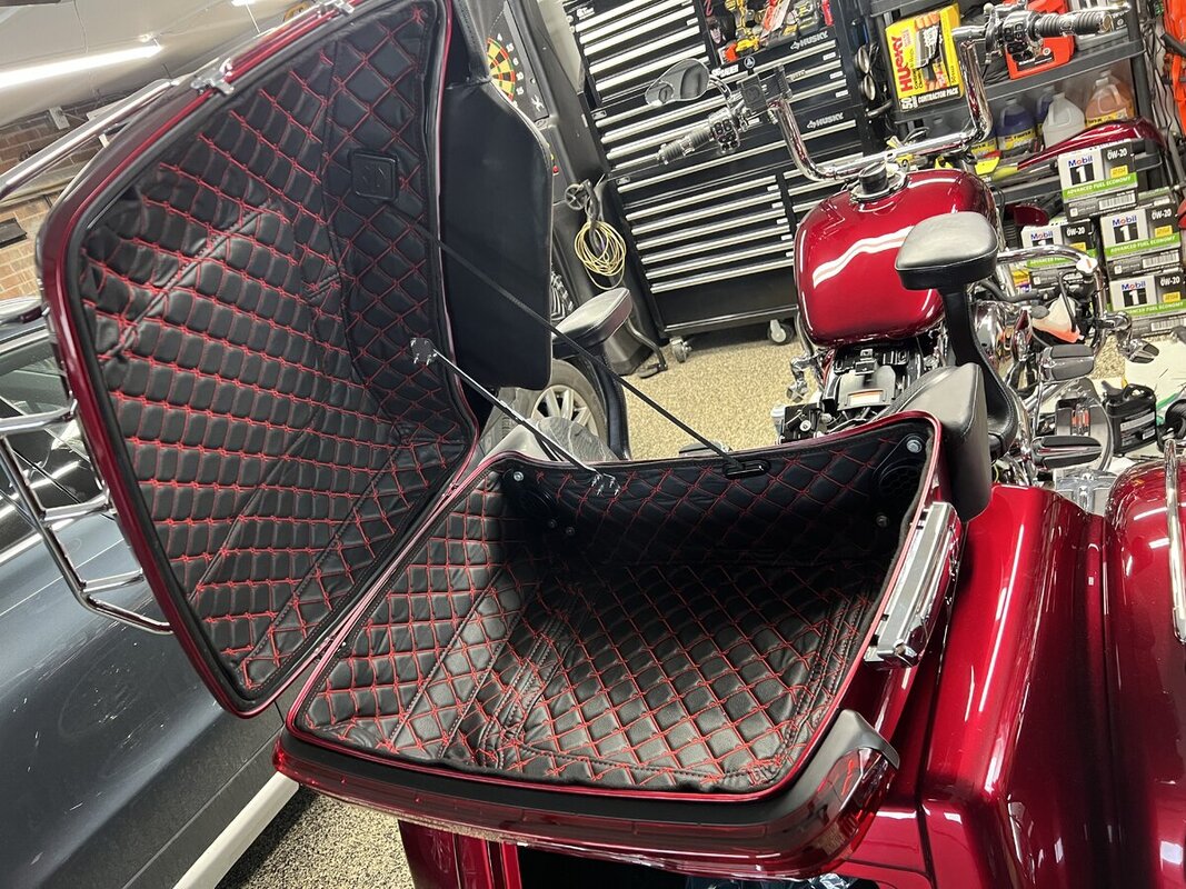

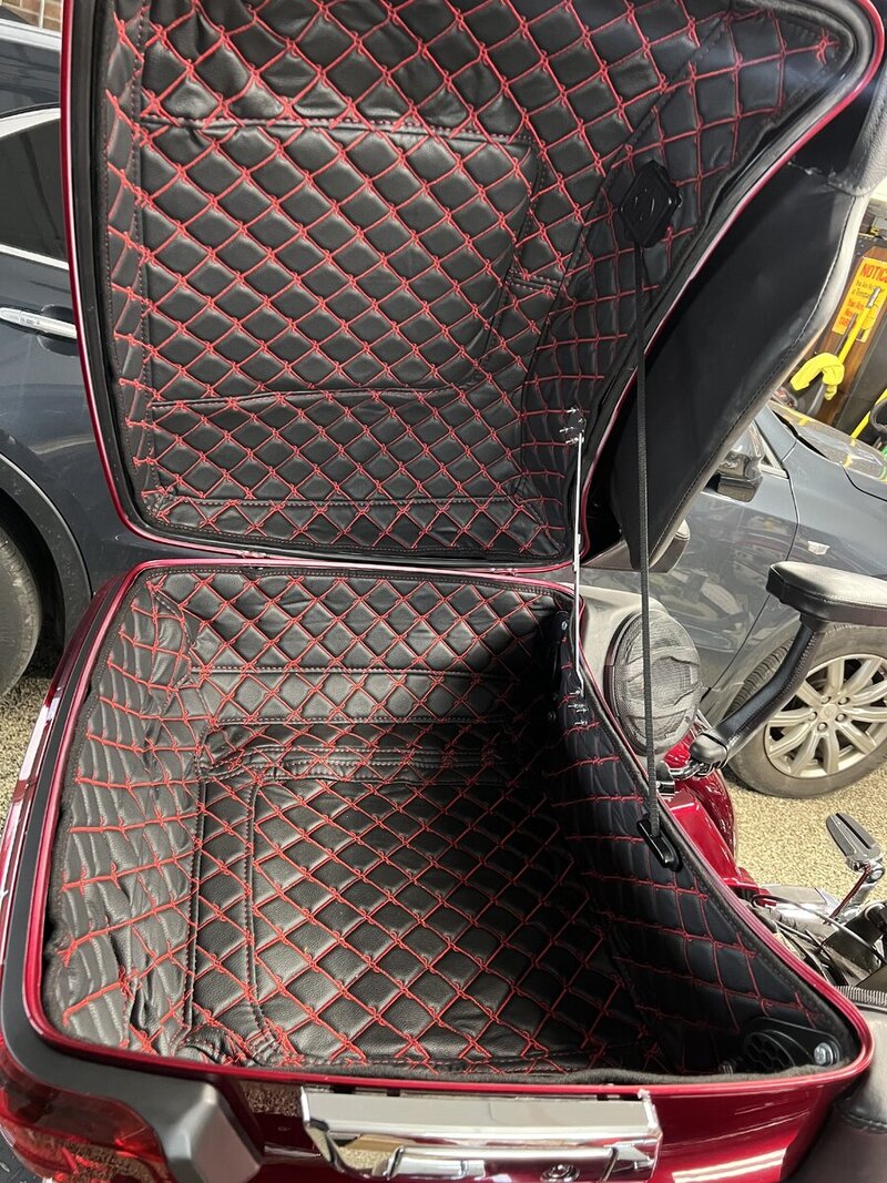

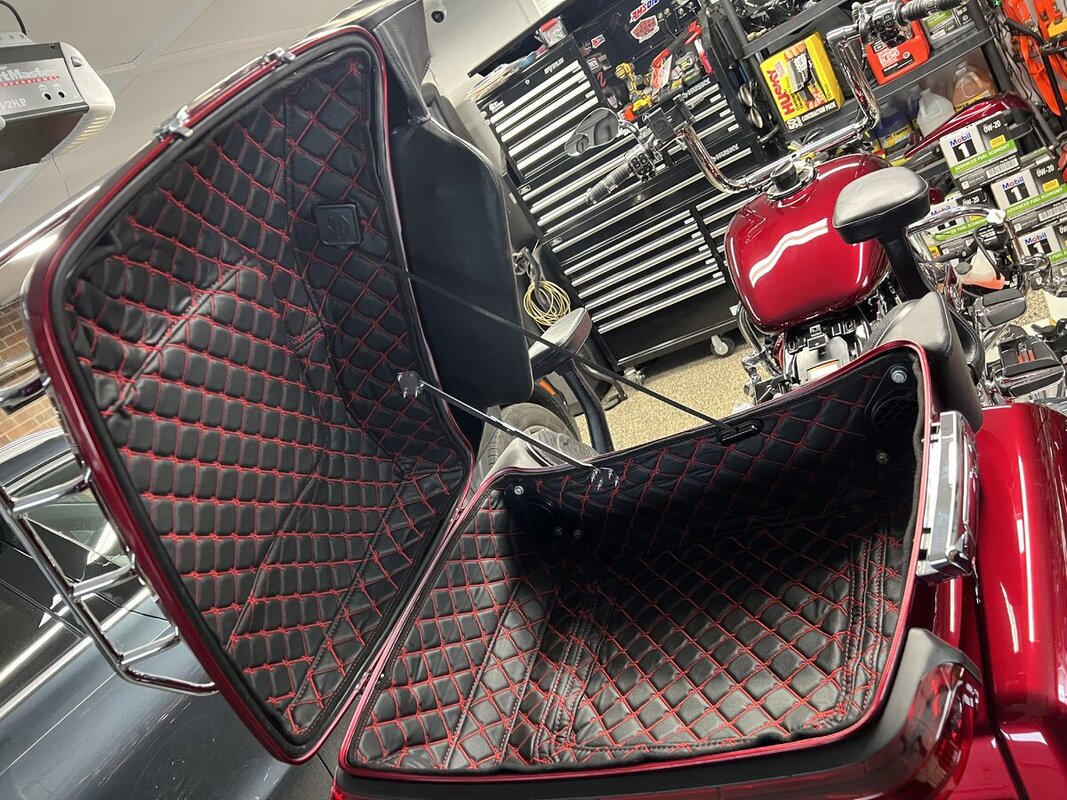

Pics of it on my 2014 Tri Glide tour pack.

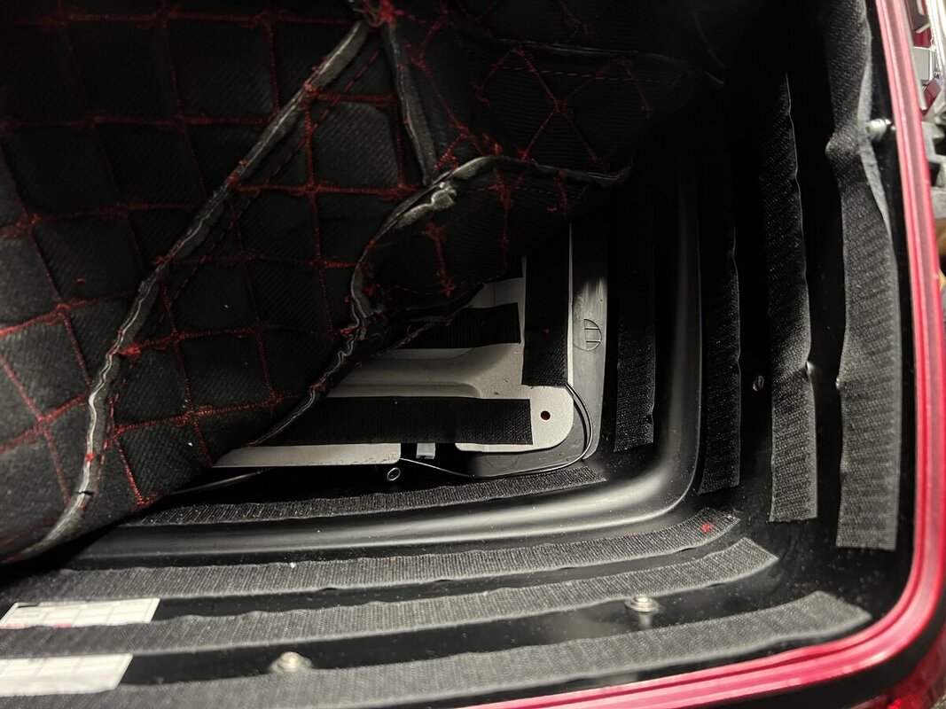

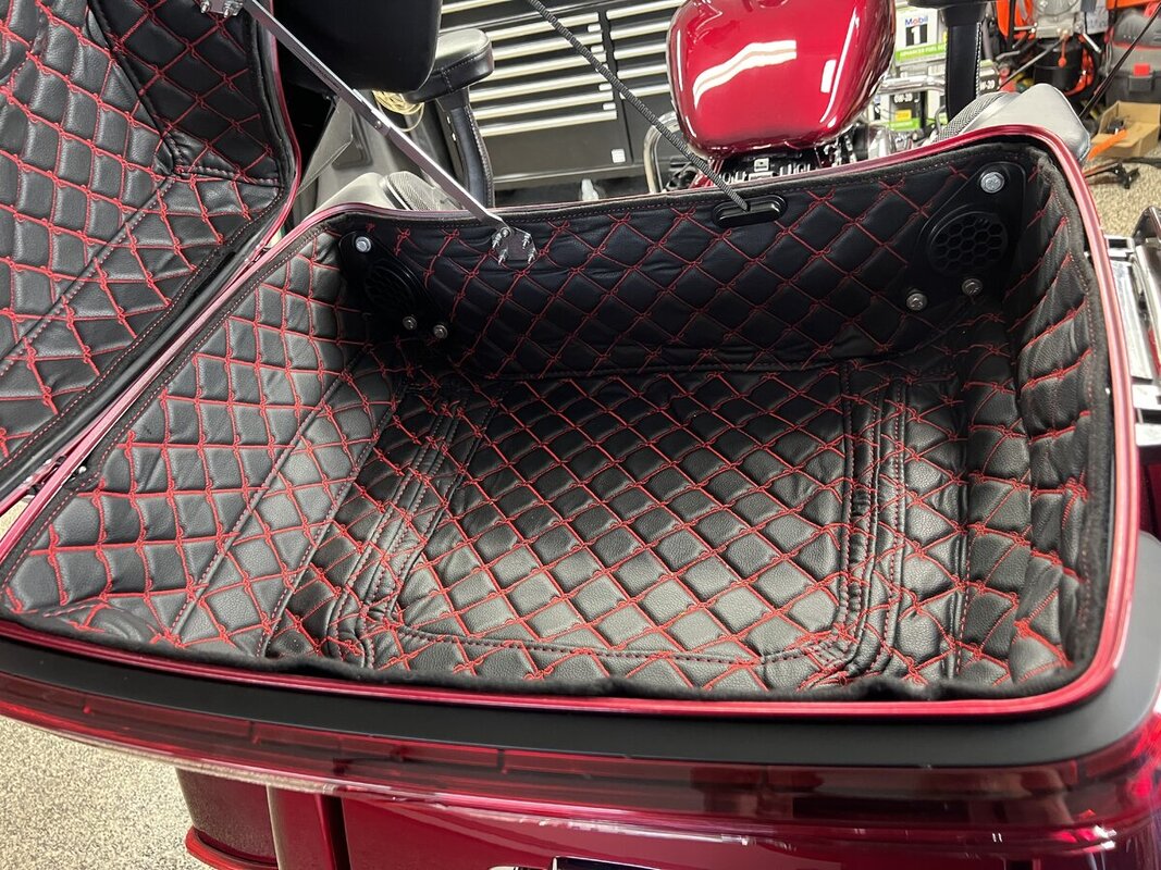

TG14, how did you get your liner to fit so well? I have one that looks just like it, Hog Works, but it doesn't fit as well as that one does.
Hi Dale, hope all is well!

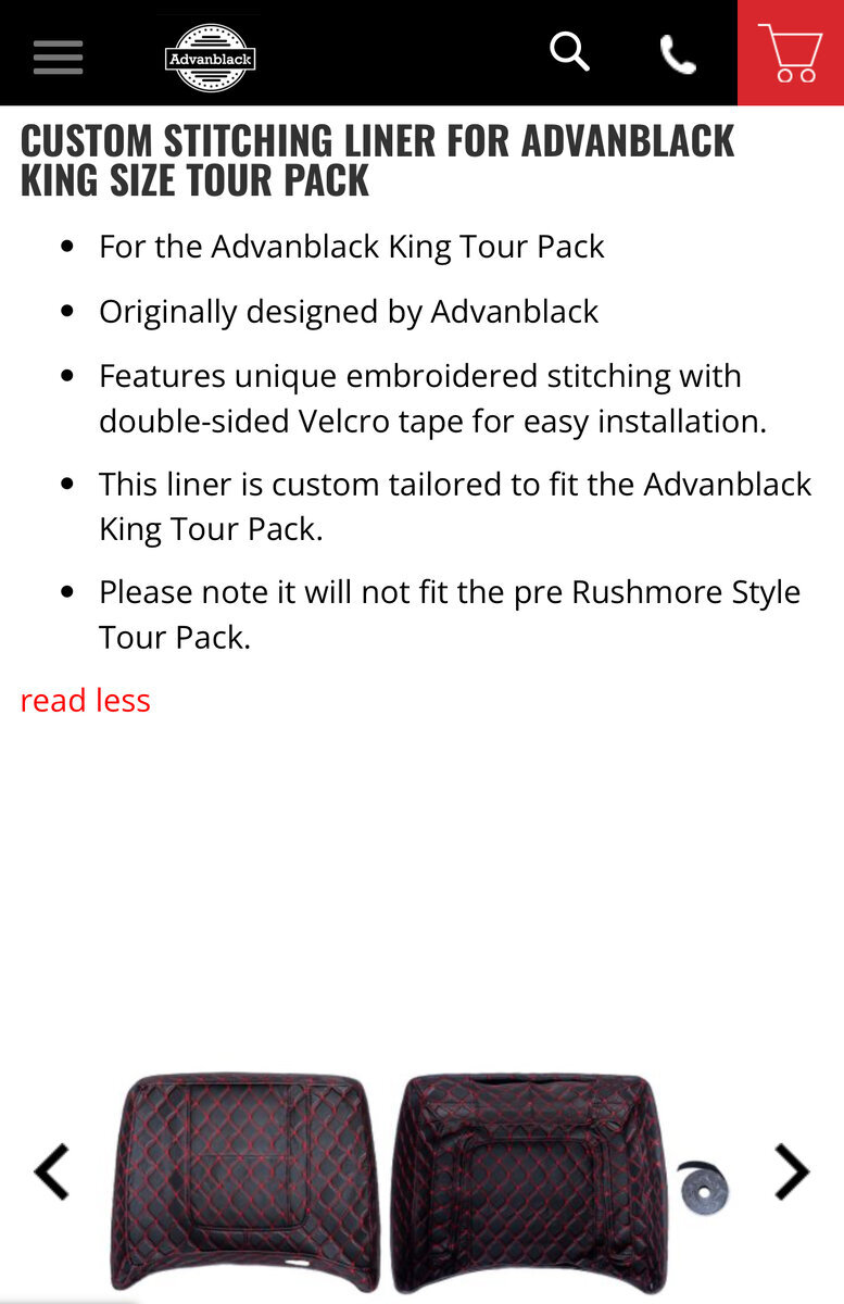

The liner in have is from AdvanBlack.

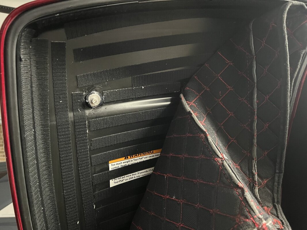

But what I also did, since they don’t give you enough “Velcro” to use, I bought a roll off Amazon (“Hook side only”) and lined about 90% both top & bottom….
Pics:
Then work the shape all the way around starting at one of the corners and push into all the “body lines” of the tour pack.
Also, in the past, some of the adhesive may start loosing its adhesion … so I always use an adhesion promoter too. (“Pro Bond” and 3M are the best, but prefer 3M).
I’ve done this on my last 3 bikes with same great results.
Amazon Link to the Velcro will help this:
Amazon link to the 3M adhesion promoter:

View attachment 133357View attachment 133358View attachment 133359View attachment 133360
