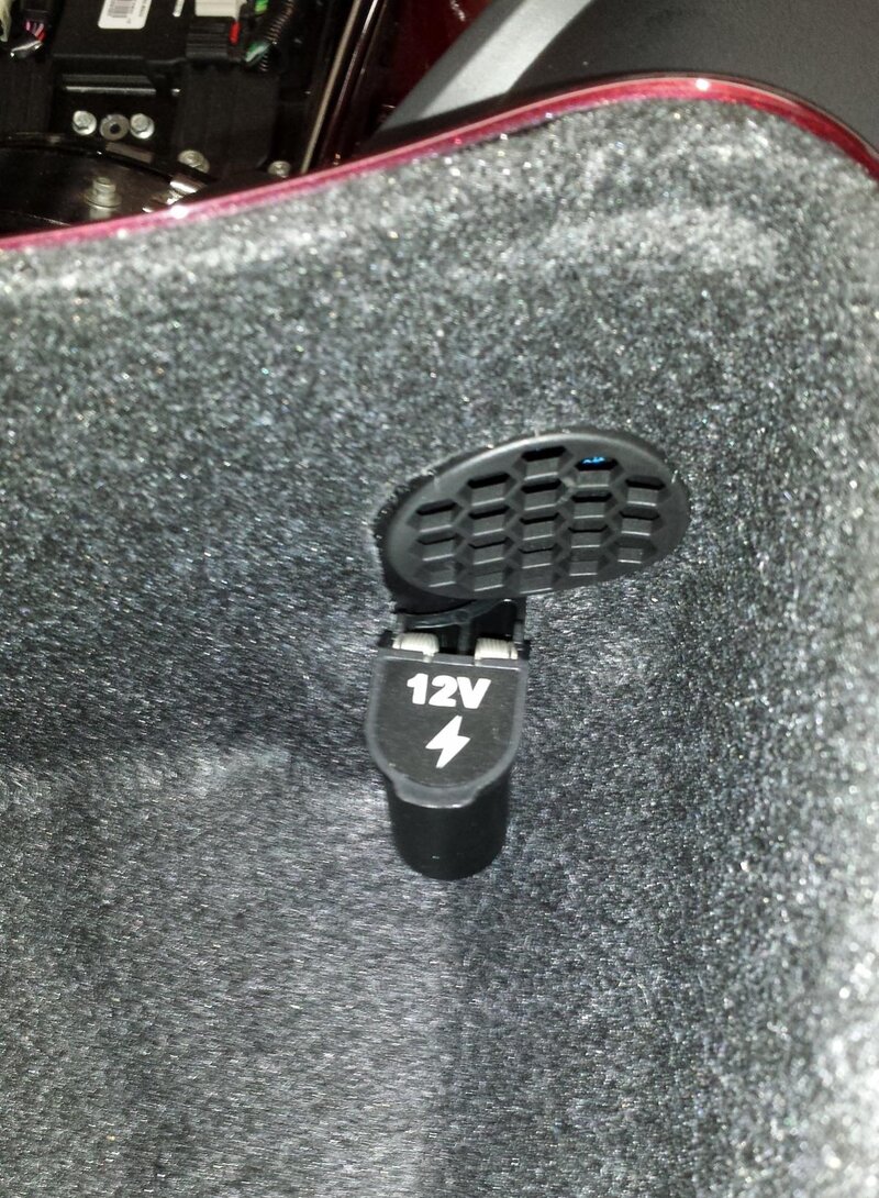

Do I remember right that someone installed the auxiliary power port in the tour pack and said it was an easy install? Wondering if it was the 91671-10 and how easy was it to install? What all did you have to do?
Installed on my 2014. Pull the bottom tour pak liner out,you have to cut a notch in it, there is a small plug on bottom of tour pak you just plug it into.Clear as mud right? Go to had website and under the product description click on more info and the install instructions are there.

I didn't realize HD actually provided install instructions on their web site. Thanks for the heads up on this. This sounds easy enough. I found out today I have a $50 gift certificate from my points rewards gonna use it to get this.

The instruction sheet says the power port is connected to accessory switch and works when switch is on.Are they referring to accessory position on ignition switch? If so does iwork also when trike is running?

Yes but remember the acc switch on the dash also must be on. It is designed to plug into the acc lead under the seat. That plug is controlled by the main switch and the dash switch.

My 2015 only has a switch for the foglights on the dash. Terer are provisions for adding switches but none exist at present.

I was told the plug under the seat is always hot. I had to reread your post to get it all into my head.
There are 2 different power ports. One plugs into the connection under the liner and another with a harness that connects to the battery.

Iam picking up the 69200826 on Saturday am.I'll let you know when it has power.

There is obviously a change in the power port between 14 and up and 13 and down. My answer was for a 13 and older.

Thanks, looks like I'm getting one tomorrow for mine also. Wife is always bugging me to charge her phone...
