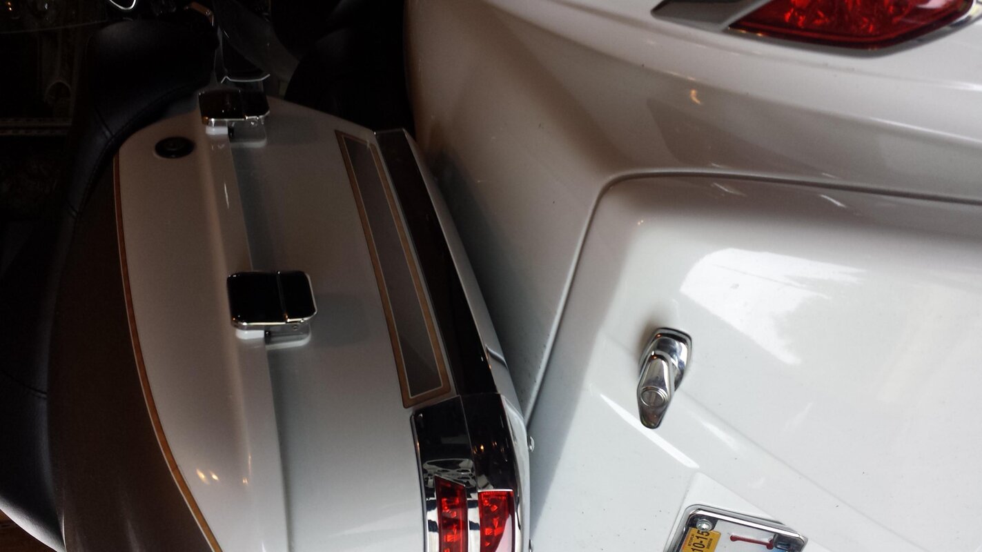

Here are some pics of what I was talking about and the finished product minus the pad I need to make.*
