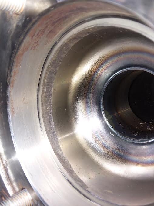

Has anyone who has pulled their axles noticed gouge marks in the tone ring housing? Exact same on both sides.0.jpg You can also see the rust at the top of the bearing race. Passenger side came right out while left side needed a slide hammer.

Has anyone who has pulled their axles noticed gouge marks in the tone ring housing? Exact same on both sides.View attachment 110185 You can also see the rust at the top of the bearing race. Passenger side came right out while left side needed a slide hammer.
When I replaced my axle bearing retainers mine looked the same. Also I took the sound advice from jack Klarich and removed the seals on the bearings very carefully and hand packed the bearings with grease. I was shocked to see how little grease was in them from the factory.
I did the same although they looked pretty good, I packed the shit out of 'em.

I understand what you're saying Jack. What I don't understand is how the retaining plate has control of the end play of the axle. The hole in the retaining plate is a lot larger than the actual diameter of the axle, if it's not a tight fit around the axle how does it control the movement? I must be missing something.
The retainer plates are stamped steel and flex a lot, especially during hard cornering
This causes the plates to distort some, thus not holding enough pressure to keep the axles from even slight movement, this will give the score marks inside the axle housing
This is not new, we saw many cars and trucks with the very same stamped bearing retainers, mid 70s saw quite a few Ford trucks with sheared axles from what I believe
to be cause and effect of the retainers
Jack, I believed every word you said. Your advice hasn't let me down yet. But I saw it with my own eyes. Sometimes that's what it takes with me. I took the retainer plates off and laid them on a surface plate. They were both warped. The worst one I could slide a 20 thou feeler gauge under one end between the surface plate and the retainer plate. It's not much, but there it is, both of them were warped. It's hard to believe that that little amount of warpage caused the problem I found. But it did. Thanks for your input
Good on you, I feel safe in saying you have just made a great move to protect your axles
Yes seeing is believing for sure, congrats on a job well done, many miles of smiles for you:clapping:
