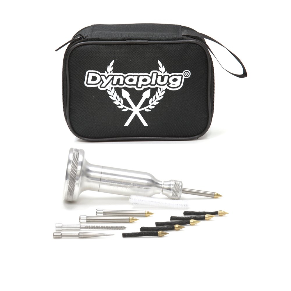

https://www.stopngo.com/ we used this on a tire years ago , rode it over 1000 miles. It was due to be changed anyway . We checked the tire when removed & plug had not moved due to the "mushroom" shape of plug . Air pressure holds it where installed.
Carry a small tube of it too. That little kit has saved my a** on more than one occasion. Made some true believers amongst a group of Banditos one year on the way to Sturgis.
