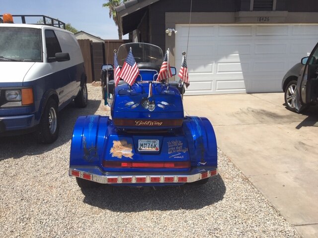

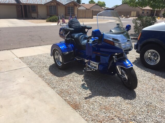

I have a little wobble after 60mph, was told its my tires. So Ive been looking and it seems the majority of GW 1500 users recommend the Bridgestone Battlax, My problem is I think Im MONK because I really want raised white letters and Id like the brand to match i.e. All Bridgestone or all Dunlop etc. I have 130/7018 Dunlop Elite II on the front and 235/60R15's Kelly MT's on the back now. I may have to bite the bullet and just get the plain black letters, But maybe someone with the same style bike has a better suggestion. Also very confused about the difference between Bias Ply and radial. I just want a smooth stable ride that looks great and is safe. p.s. Not even sure what my bike really is to begin with the vin tells me its a 1996 Honda 1500 Goldwing but I dont know the version or the conversion brand, any help would be greatly appreciated ThanksIMG_L4549.JPGIMG_L4551.JPG

You have a MotorTrike Conversion with linked suspension.
Check your tire pressures. (20psi rear)(38psi front)
See if the wobble fades away.
If the wobble persists check the front tire for uneven wear or cupping and check rear suspension.
Grab the right handlebar and move it briskly back and forth an inch or two each way to see if there is any play in the suspension linkage.
The linked suspension consists of heim joints and rods, sometimes these joints will get worn and cause a side to side wobble. If their is noise present (clicking or popping) try to identify where it is coming from.
You have coil-over shocks and airbags in the rear, make sure the airbags are inflated (35psi).
You can regulate the air pressure in the airbags for the best ride and handling.
PRETTY TRIKE!
