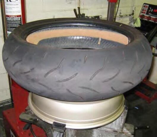

Ride-on I would think makes for a nasty rim at tire change time... I know Slim does, that why I use tubes to avoid the mess.... I sure don't want my tire balancer PO'D at me!!!
:gah:
Ride-On is not like Slime. It does not make a mess. Tire changer won't even be able to tell, except for a tan band on the inside of the thread surface. If you get a nail, pull nail, inflate tire and go for a ride to warm tire. Hole will seal itself. Read the write-up. :)
Agree 100%. There will be no mess w/RideOn. I have used this product for many years on many bikes.
As to the comment on how would you know if you pick up a nail. You need to inspect your tires periodically.
Looking at the pic in your post, the band of RideOn does not look wide enough to me! Are you sure you are installing the proper amount?

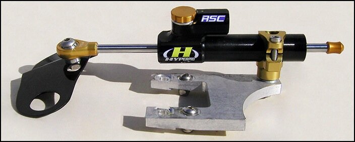

This is interesting:
Our patented GL1800 Steering Stabilizer
Eliminate Goldwing Fork Wobble & Front Tire Cupping!
Reduce Tire Wear On Your Goldwing Motorcycle or Trike!
• Front Fork Stability Control
• 22 Settings for Fine Tuning
• Adjustable From Driver's Seat
• Race-Proven Technology
• Patented Bracket Design
• Bolt-on Installation
(No Drilling Required)
• Improved Tire Life
• Vastly-Improved Handling
• A Proven Permanent Solution
• Does NOT Affect Your Motorcycle's Warranty
• Comes complete with all brackets, mounting hardware and installation instructions
• 2-Year Warranty
(No Drilling Required)e,
Really!!!
Vastly-What ever!
Solution for what?
Maybe, maybe not!! If one really reads the fine print, one would find, any mod or accessory not manufacturer approved and not installed by an authorized dealer MAY affect a warranty claim!
• 2-Year Warranty
Another whole different topic are these items!!! I rank this item about as high as I do fork braces but, I need to stifle myself and not go there.
The HD trikes come w/a stablizer-wondering why? Rake/Trail have a lot to do w/"wobble" or lack there of.
I have read or heard of so many variables on this but the crown on the road I call BS.
Just way too may variables to chose one thing as the source. It is a multiple reasons.
+1 to Both ThumbUp
And,,, IF One feels the need for a Steering Dampener on a Trike (or it actually does acceptably treat the unacceptable "Symptoms"), that Trike has some Design, Geometry, and/or Alignment/Mechanical Issues.
As a Symmetrical Unit, unlike an Asymmetrical Sidecar Rig, a Trike SHOULD have Zero Need for such an Add-On.
Dampener on a Trike is like treating the Cough you get from having a Respiratory Infection and thinking it's all good.
The real "Issue" ain't the Cough.... ;)
A whole lot of People making tons of money selling "Cough Syrup" tho ain't they :D
