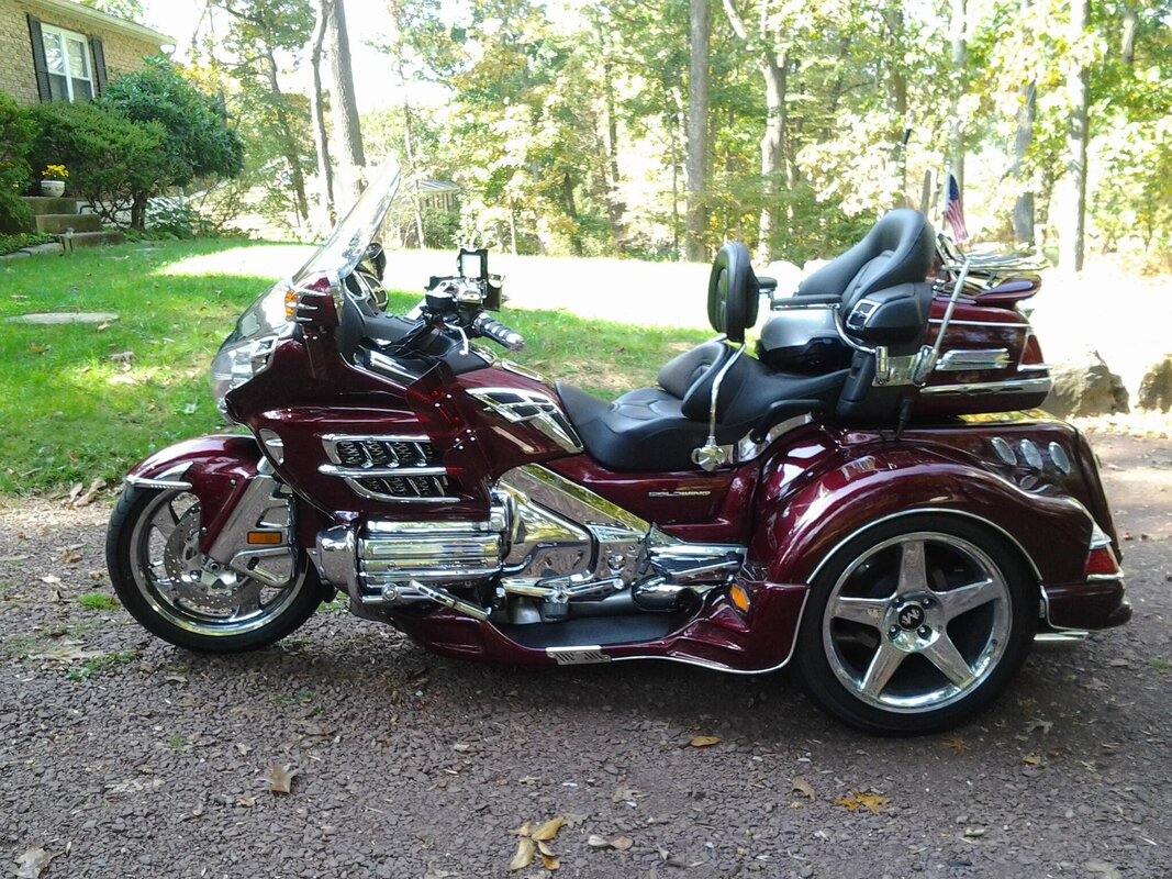

I have the 2004 Goldwing with the Prowler RT reverse kit. I really enjoy riding it. The only problem is that you can't make a tight U-turn because the turning radius is very small. Other than that, I feel as though I am driving a tank. For me that's good. No, I can't lean but I sacrifice the leaning for feeling safer when I ride. I have been riding trikes since 2011 when I decided that the two wheelers were getting too heavy for me to push around. I have had 4 Canam Spyders and 1 2005 Goldwing Trike with the Lehman Monarch II kit. That was a great bike. I sold it because I couldn't find anyone who could eliminate the rubbing sound coming from the braking system.
Motogordo002 (3).jpg Then
2021-12-23 012.jpg Now

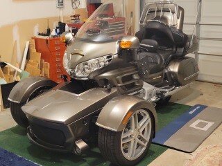

As you can see, I have a 2004 GL1800 with the Motor Trike Prowler RT kit. I have had it a couple of months so far and enjoy riding it. As you pointed out, you can't make a tight U-turn. Other than that I have no problems. I do feel like I am driving a TANK. Very safe however. I like to be different also. There are very few on the road. I have had 4 Canam Spyder's and they were great also.Love the power steering.
I guess I'm old fashioned but I LOVE your old 2005 that thing is beautiful and very tasty
Something like that will be my next one
Thank you, it was a great trike. I like variety so I purchased the Prowler RT. I don't think there are any withing 3,000 miles of my house. LOL.
I haven't seen any and don't expect to.
