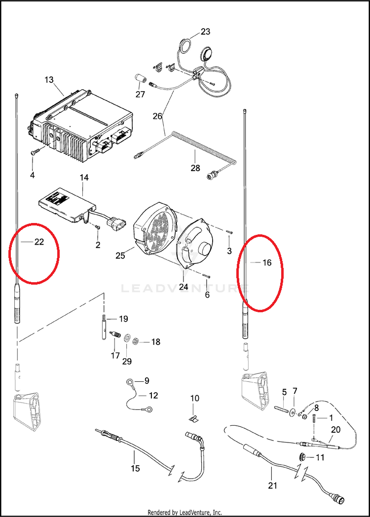

What antenna are you using? I use a shorter one and my reception is not the good but i expected that. If I put the factory long one on I get better reception.
Make sure you are using a radio antenna and not a CB antenna, they are marked as such at the bottom.
Ref:16
76250-09
ANTENNA MAST C.B.
Price: $41.26
Ref:22
76503-08
ANTENNA MAST AM/FM/WB/LW
Price: $23.45
