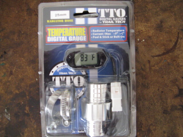

After 2 head gaskets on my 1300 VTX within 1 year, this gets installed this weekend. $48.00

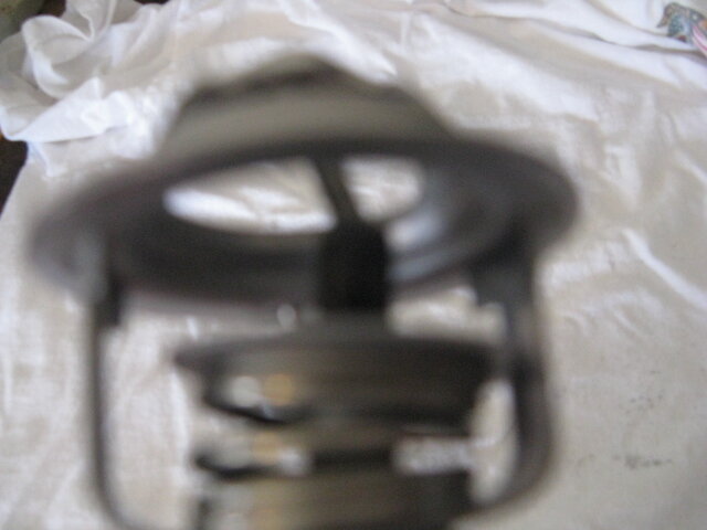

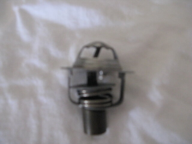

I wish I had a dollar for every time I heard how bullit proof the VTX is. One year ago the motor was removed from the frame and all of the aforementioned checks were done along with gaskets, seals, sensors etc. Heads and cylinders checked and trued. This time we added new bolts. T-stat was found broken in the open position.

T-stat opens at 82 degrees C. I'm assuming that the running temp would be 180-200 degrees F?? Install the sensor top or bottom of rad??

Temp gage installed and I couldn't be happier.:pepper: Started bike up cold. Took ten min of idling for fan to come on. Fan cycles between 208 and 216 degrees. If I ever see 220 I'm shutting the damn thing down.:mad:
NORMAL DRIVING TEMP 30-55 MPH SEEMS TO BE 185-200 DEGREES
