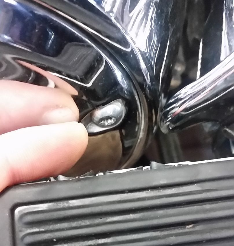

Couple more photos-
This is a 2014 Rushmore, the passenger floorboard is adjusted to its' lowest position with adjustable passenger footpegs mounted to it.
It is Not a reduced width primary.
This one torx fastener is directly behind the floorboard...and whether it is down flat or turned up, it is completely blocked...a wobble will not get in there.
Even a low profile ratchet is too wide to fit in the space between the floorboard and that one torx fastener.
