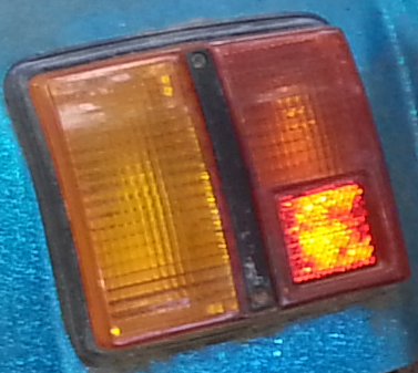

Hello all,
I just purchased a Rewaco HS1 from 1996. I'm busy repairing it and making it street legal since it has been sitting around in the weather.
I have a full fiber body so compared to the ones with individual rear fenders the tail lights are different
In an other forum I read that the separate fender type use Landrover rear lights.
I was wondering if for the Full fiber body there is also an off the shelve Package.
If so what model vehicle and year would these be off.
P.S. the lens or assembly I'm seeking is about 16cmx16cm and has red and orange halfs
Thanks in advance

Can you take a couple of pictures and post them?
That might help narrow it down or someone might recognize the tail light lens.
Ah crap, I just noticed you only have 1 post under your belt. LOL. Post up some other stuff to get ya up to 5 posts and then you can include pictures in your responses.
Hmm, man, I don't recognize them at all. Maybe one of the other VW members will know what they are.
I know there was a fellow member in here recently that just picked up a Rewaco trike as well. Maybe he might chime in soon.
I did write rewaco USA and they asked me to send a picture since I thought they would know by the model what to look for. They said that they would look if there factory in Germany could provide it. Nothing back yet.
Indeed this Trike has been imported from the Netherlands. So I would also think that it is European.
I would not have a problem to hook up a different rear light. But the issue I have is that the fiberglass body is pre-formed towards this tail light model (so there is like a "pedestal") and if I want to use something else you will see that there should have been something else. This is what I would like to avoid. BUT if it is more difficult then I thought it would be to find, I will have to start thinking of modifying the body anyway.:(
Finally found them!!
I finally found the rear lenses I was looking for. And I though i'd post it for if someone else is looking for this info. The tail lights are taken off an autobianchi A 112 series 1 or 2.
