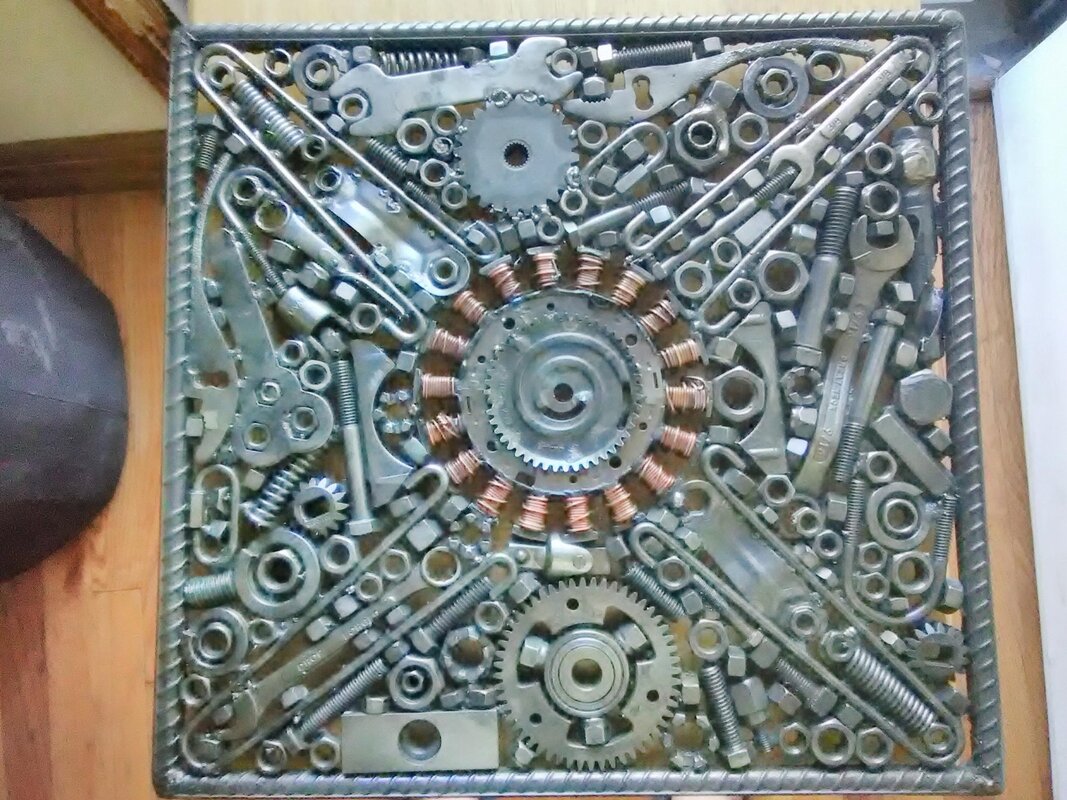

Just finished the top
It was a lot of small spot welding
welded he bottom and flipped it over to see the top
I wanted to use a crank and flywheel for the base but the only ones I have are in good shape so I don't want to destroy them
Need to think about the base more
That's a clever use for odds 'n ends parts. I like that, very creative. :clapping:

This boy got talent.........:clapping:

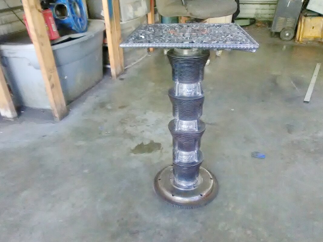

Thanks everyone!!
So how high should it be?
The only thing I have to go by here are table trays and some end tables
Got plans for another one in my head now
Thanks everyone!!
28 to 30 Inches......So split the difference 29 inches...:)
In the end it came out to be 24 1/2 lowest and 26 7/8 highest
I used a 1 inch bolt in the center to make it adjustable.
I should have bought a longer bolt to make it adjust higher. But it fits good next to my chair
All you have to do is turn the top to screw it up and down
I used VW Cylinders and a flywheel as a base.
Welding the Cyls was a pain. The top of the Cyls are thick, the bottoms are thin.
The thin part kept cracking as it cooled down.
Had to do a spot weld then lit it cool the do another and so on
I also added some rebar supports between the cyls
