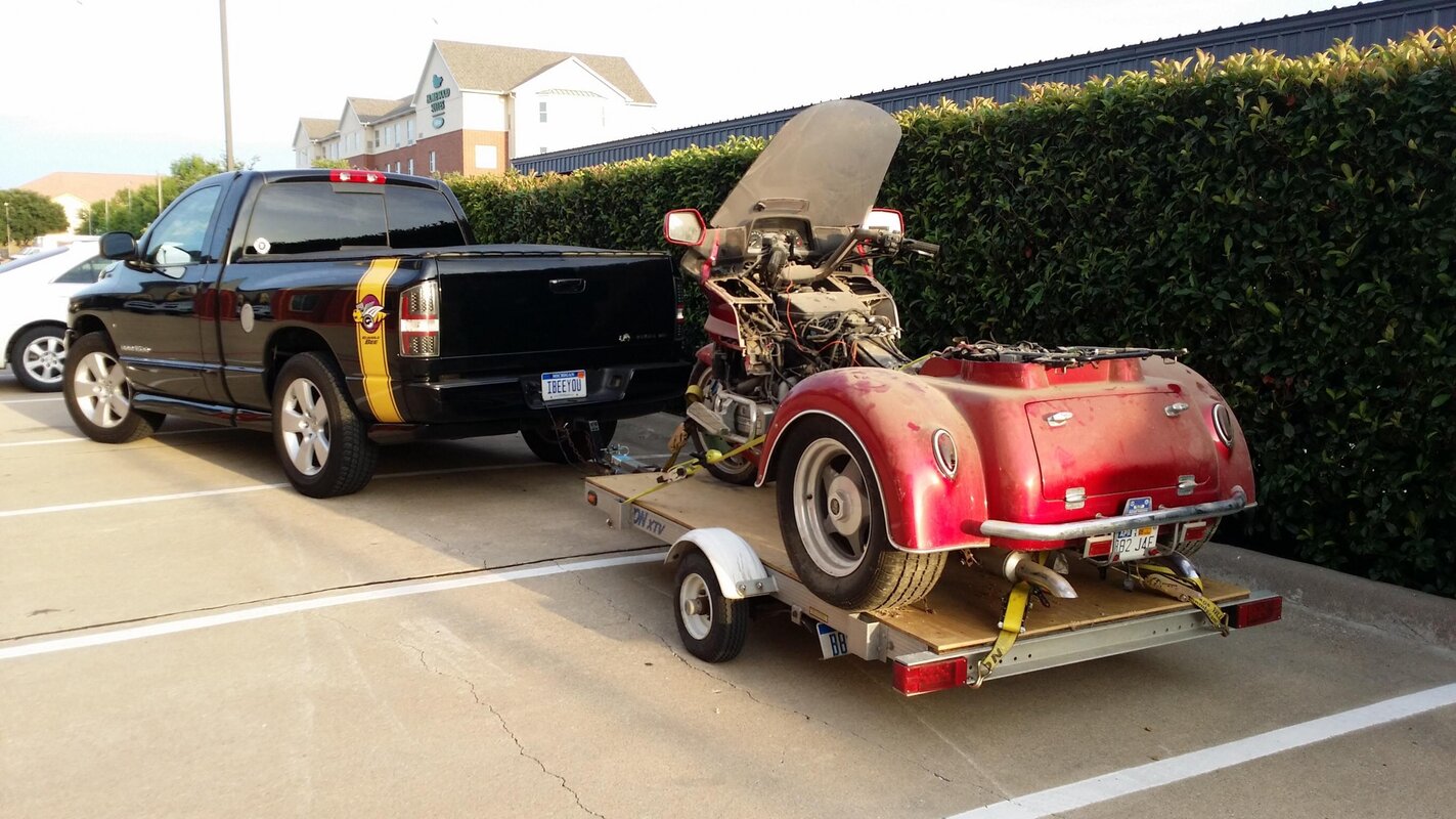

My 8.00" load range "C" tires call for 90psi. That's what I ran. The load range "B" called for 60psi. I was carrying a gl1500/ motortrike on a 4X8 Triton aluminum trailer. I had the load range "b's" on it and at 60psi they were overloaded. The "C's" at 90psi did the job flawlessly, from DFW Texas to East China Mi. at 75-80 mph!!
image.jpg I admit, I was at the ragged upper limit of the trailer. The "c" tires called for 749 lbs. per tire giving me about 1500 lbs. capacity. I had extra bearings, seals and a complete hub assembly PLUS 4 spare tires! I wasn't worried! As to a trailer with a light load as we would put behind our bikes/trikes, you can keep almost any pressure you would want in the tires. BUT as you go to a lighter pressure, the tire's flat (bottom) is constantly changing its position causing the tire to be flexing constantly which in turn caused excessive heat build up. (these tidbits came from a wheel and tire engineer at Chrysler many years ago!)
