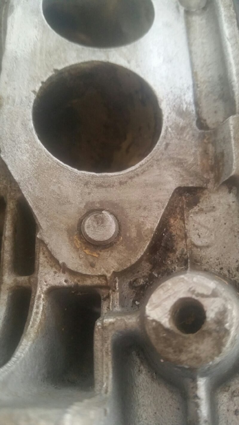

Well, just my sh!thouse luck...
Got the first one to turn out with some heat and a pair of vise grips. The second one snapped off in a big hurry, flat with the gasket surface. There MIGHT be half a thread sticking out above the surface. So, tomorrow I have a riding buddy coming by with a portable welder. He runs a shop in Vienna and says he has a trick for getting broken studs out of aluminum heads. If it works, I'll post pics of the process. For tonight, I'm just disgusted and calling it quits for the evening.
PEACE and ride safe!

removed a lot of broken studs on blanking and forming dies......now this was in steel.....i think the same principal applies.... we used 3/32 stainless welding rods cut to about 3in long. had a piece of scrap close to the broken stud used to strike the arc and warm up the rod. i have used dc reverse or ac 60/75 amps strike the arc on the scrap then swing over to the stud, keep a short arc for 3 seconds or so making a ball on the stud, when it cools from red....tap on the stud,,,,the ball will spread out..about the dia. of the stud....repeat weld and tapping about 3 or 4 times or until enough material there to get a vise grip on the ball. then turn out the stud,,,,the heating and pounding loosens the threads enough to remove the stud, the welding just gives you something to grip on. we found stainless steel arc rods work the best. if the threads were not jammed we welded a bolt to the ball by holding the bolt at a 45 deg angle to the ball. then tip the bolt slowly vertical while welding. then screwed it out with an impact wrench. anyhow my. 02 looking forward to seeing your friends method! good luck!
Weld a nut to it.
Weld down in the hole in center of nut.
That's what worked! Started by welding a flat washer to the stud, then a nut to the washer. Took two attempts, but out it came, slick as a whistle. With that out of the way, it's time to mock up the ancillary stuff and get this beast on the road!

Weld a nut to it.
I was just going to suggest this trick. Of course, Rex beat me to it. :laugh:
Awesome that it worked for ya Doug!!!
