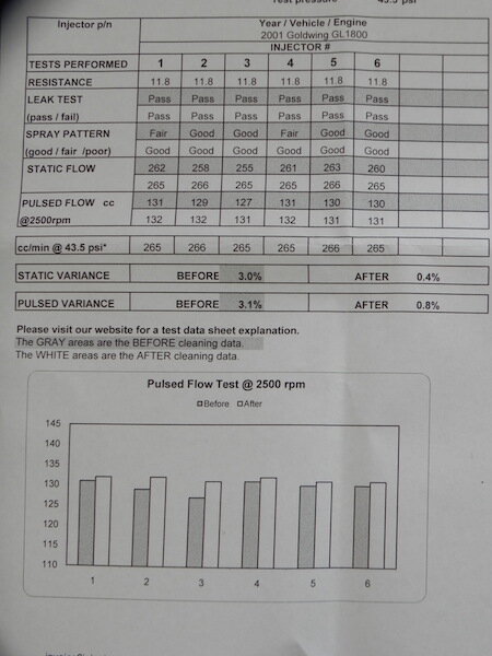

After trying the SeaFoam method, I was left with 1 intake valve that would not spring closed by itself (#5), and I was not able to open it further by hand. I remove the injectors and shipped them to a professional injector cleaning company in Kansas. The injectors squirt directly above the intake valve stem, and with them out, it allows for some access to the stem.
After the SeaFoam cleaning, the stems still had large, loose particles of black carbon on their exposed stems. A few shots of carb cleaner, the stems looked shinny. With #5 I shot the stem with penetrating oil and let it soak. It would still not free. After making sure the piston was down, I lightly tapped on its bucket with an aluminum drift and it started freeing. I believe "mechanical" everything should now be good with the valve train.

The other possibility that I can think of is a leaking injector. However, the report I got back from the injector-cleaner-guy was that "there was no evidence of a leaking injector. 2 were very dirty."

In this case, the injector cleaner guy said he was not able to verify that one leaked ... therefore, I think you mean a squirting injector as it comes to rest. Yes ... I could possibly do your test. However, you sound like you're a professional mechanic too. Like you I'm in no way a fan of additives for anything. Additives seem to be a DIYr thing ... or a suggestion from a lower level mechanic, or a tire buster, or lube tech., or an installer level mechanic thing, or because the parts man suggested it. Usually higher level techs, will not recommend such stuff unless they understand the problem and have personally verified the results of trying an additive ... which is completely different then just "believing that it's ok ... or because the bottle says to ... or John does it, so I'm gonna too."
